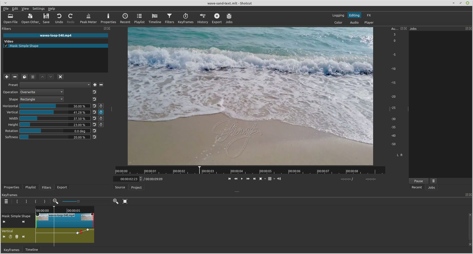

Teaching you how to use a video editor is well beyond the scope of this forum. I'm not interested in making a tutorial either. However I'm posting the project files instead. Just load the "wave-sand-text.mlt" into ShotCut and anylise what I've done. Play with the settings to see what it does.
Masks work the same way in video as in images, the difference is you can animate them in video using Key Frames. In this case I moved the mask in vertical axis to chase the wave.
I used 3 video tracks (similar to layers) V1= video clip, V2= text object and V3 is a duplicate video clip to put the mask in.
