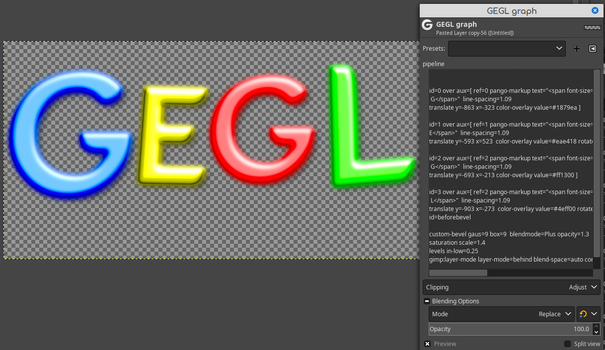

Joined: Oct 31, 2020
Posts: 2025

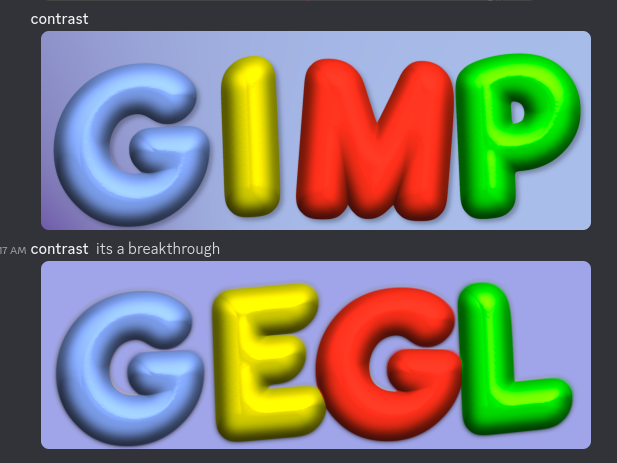

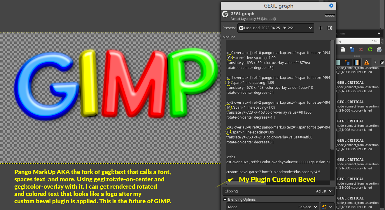

REQUIRES GEGL PLUGINS
https://github.com/LinuxBeaver/GEGL-Custom-Bevel/
https://gitlab.com/barefootliam/gegl-pango-markup
and a very large composition.
id=0 over aux=[ ref=0 pango-markup text="<span font-size='494900'   letter-spacing='-125000'  fgcolor='#ee8fff'   font='Birbaslo' font-features='ss10'>
  G</span>"  line-spacing=1.09
translate y=-693 x=013 color-overlay value=#1879ea
rotate-on-center degrees=3 ]
id=1 over aux=[ ref=1 pango-markup text="<span font-size='494900'   letter-spacing='-105000'  fgcolor='#ee8fff'   font='Birbaslo' font-features='ss10'>
  I</span>"  line-spacing=1.09
translate y=-673 x=423  color-overlay value=#eae418
rotate-on-center degrees=5 ]
id=2 over aux=[ ref=2 pango-markup text="<span font-size='494900'   letter-spacing='860000'  fgcolor='#ee8fff'   font='Birbaslo' font-features='ss10'>
M</span>"  line-spacing=1.09
translate y=-723 x=-163 color-overlay value=#ff1300
rotate-on-center degrees=-1 ]
id=3 over aux=[ ref=2 pango-markup text="<span font-size='494900'   letter-spacing='1349433'  fgcolor='#ee8fff'   font='Birbaslo' font-features='ss10'>
P</span>"  line-spacing=1.09
translate y=-753 x=-213  color-overlay value=#4eff00
rotate-on-center degrees=6 ]
[attachment=1]2023-04-25_17-42.png[/attachment]
id=b1
dst-over aux=[ ref=b1 color-overlay value=#000000 gaussian-blur std-dev-y=13 std-dev-x=12 opacity value=0.08 translate x=24 y=13   ]
custom-bevel gaus=7 box=9  blendmode=Plus opacity=4.5
saturation scale=1.4
levels in-low=0.29
gimp:layer-mode layer-mode=behind blend-space=auto composite-space=auto composite-mode=auto aux=[ ref=beforebevel dropshadow opacity=0.55 x=20 y=15 ]
 Post subject: Re: Learn GEGL graph
PostPosted: Tue Apr 25, 2023 6:32 pm  (#46)
Posts: 2025
translate y=-693 x=103 color-overlay value=#1879ea
  E</span>"  line-spacing=1.09
translate y=-673 x=473  color-overlay value=#eae418
translate y=-723 x=33 color-overlay value=#ff1300
L</span>"  line-spacing=1.09
translate y=-753 x=-33  color-overlay value=#4eff00
id=b1
levels in-low=0.29
Update for May 2023 Custom Bevel Update.
translate y=-693 x=-163 color-overlay value=#1879ea
translate y=-673 x=273  color-overlay value=#eae418
translate y=-723 x=983 color-overlay value=#ff1300
translate y=-633 x=1433  color-overlay value=#4eff00
id=b1
custom-bevel gaus=7 box=9  blendmode=Plus opacity=4.5 restorepuff=true
levels in-low=0.29
Another Example of the May 2023 Update Custom Bevel. This is the gimp logo graph.
id=0 over aux=[ ref=0 pango-markup text="<span font-size='614900'   letter-spacing='-65433'  fgcolor='#ee8fff'   font='Birbaslo' font-features='ss10'>
translate y=-993 x=-363 color-overlay value=#1879ea rotate-on-center degrees=6.1 custom-bevel gaus=9 box=9  blendmode=Plus opacity=1 gimp:threshold-alpha edgesmooth dropshadow opacity=0.6 radius=8 x=10 y=4 ]
id=1 over aux=[ ref=1 pango-markup text="<span font-size='454900'   letter-spacing='9433'  fgcolor='#ee8fff'   font='Birbaslo' font-features='ss10'>
i</span>"  line-spacing=1.09
translate y=-593 x=653  color-overlay value=#eae418 rotate-on-center degrees=-1.6  custom-bevel gaus=9 box=9  blendmode=Plus opacity=1 gimp:threshold-alpha  edgesmooth dropshadow opacity=0.6 radius=8 x=10 y=4 ]
id=3 over aux=[ ref=3 pango-markup text="<span font-size='484900'   letter-spacing='9433'  fgcolor='#ff0020'   font='Birbaslo' font-features='ss10'>
p</span>"  line-spacing=1.09
translate y=-584 x=1114  color-overlay value=#30ff00 rotate-on-center degrees=5.3  custom-bevel gaus=9 box=9  blendmode=Plus opacity=1 gimp:threshold-alpha  edgesmooth dropshadow opacity=0.6 radius=8 x=10 y=4 ]
id=2 over aux=[ ref=2 pango-markup text="<span font-size='454900'   letter-spacing='9433'  fgcolor='#ff0020'   font='Birbaslo' font-features='ss10'>
m</span>"  line-spacing=1.09
translate y=-593 x=753  color-overlay value=#ff0020 rotate-on-center degrees=-1.6  custom-bevel gaus=9 box=9  blendmode=Plus opacity=1 gimp:threshold-alpha  edgesmooth dropshadow opacity=0.6 radius=8 x=10 y=4 ]
levels in-low=0.25
We are in the deep GEGL era of Gimp's history. Before late 2022 it was the early GEGL days now progress has been made.
Requires
https://github.com/LinuxBeaver/GEGL-glo ... xt-styling
  C</span>"  line-spacing=1.09
translate y=-693 x=-03
rotate-on-center degrees=3 id=recolor1 gimp:layer-mode layer-mode=hsl-color aux=[ ref=recolor1 color-overlay value=#1a1eff  ] ]
rotate-on-center degrees=5  color-overlay value=#fffe00 ]
S</span>"  line-spacing=1.09
translate y=-723 x=243
rotate-on-center degrees=-1 color-overlay value=#ff1300  ]
R</span>"  line-spacing=1.09
translate y=-753 x=213
rotate-on-center degrees=6 color-overlay value=#4eff00 ]
id=everything
glossy-balloon gaus=20 saturation=0 hue=55
gimp:layer-mode layer-mode=multiply opacity=0.86 blend-space=rgb-perceptual  composite-mode=auto aux=[ ref=everything median-blur alpha-percentile=100 radius=50 ]
levels out-high=1.5
hue-chroma lightness=3
rotate-on-center degrees=3 id=recolor1 gimp:layer-mode layer-mode=hsl-color aux=[ ref=recolor1 color-overlay value=#1879ea ] ]
translate y=-723 x=90
translate y=-733 x=73
id=everything
gimp:layer-mode layer-mode=multiply opacity=0.82 blend-space=rgb-perceptual  composite-mode=auto aux=[ ref=everything median-blur alpha-percentile=100 radius=50 ]
levels out-high=1.5
saturation scale=1.9

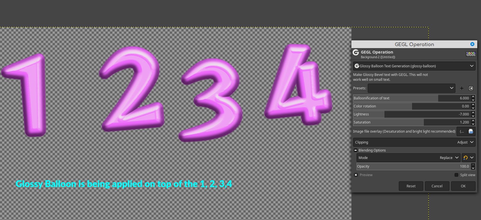

UPDATE FOR MAY 2023 Glossy Balloon update
translate y=-723 x=1300
translate y=-553 x=1840
id=everything
glossy-balloon gaus=20 saturation=0 hue=55  removetransparency=true
gimp:layer-mode layer-mode=multiply opacity=0.82 blend-space=rgb-perceptual  composite-mode=auto aux=[ ref=everything median-blur alpha-percentile=100 radius=80 ]
levels out-high=1.5

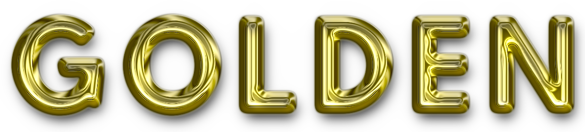

PostPosted: Fri Apr 28, 2023 8:51 pm  (#50)
Posts: 2025
This requires Pango Markup and and Custom Bevel that you can find above in this thread.
Also a very large canvas. Type anything and go.
#text is here
id=0 over aux=[ ref=0 pango-markup text="<span font-size='250000'   letter-spacing='32926'  fgcolor='#8af7ff'   font='Tahoma' font-features='ss10'>
SPECIAL
NEEDS
</span>"  line-spacing=0.89
translate x=120 y=40
rotate-on-center degrees=0  ]
#median blur to manipulate font
median-blur radius=10 alpha-percentile=20 neighborhood=diamond
#custom bevel plugin
custom-bevel size=4 gaus=4 box=5  opacity=4.9 coloroverlay=#ffcc99 blendmode=Softlight azimuth=54 percentile=1
alien-map cpn-1-frequency=5 cpn-2-frequency=3 cpn-2-frequency=13
gimp:desaturate mode=average
hue-chroma lightness=-5
#master opacity
opacity value=8
#gold color overlay
id=color
gimp:layer-mode layer-mode=hsl-color opacity=0.020  composite-mode=auto  aux=[ ref=color color-overlay value=#fff17f  box-blur radius=30 ]
noise-reduction iterations=5
#trick to get drop shadow working
id=shadow
gimp:layer-mode layer-mode=behind opacity=0.024 aux=[ ref=shadow color-overlay value=#000000 gaussian-blur std-dev-x=12 std-dev-y=12  translate x=10 y=14  ]
saturation scale=1.15
#text is here
Type
Any
Thing
hue-chroma lightness=-3
#master opacity
opacity value=8
#gold color overlay
id=color
id=shadow
Update Graph for Custom Bevel May 2023 update.
#text is here
GOLD
custom-bevel size=4 restorepuff=true gaus=4 box=5  opacity=4.9 coloroverlay=#ffcc99 blendmode=Softlight azimuth=54 percentile=1
#master opacity
opacity value=8
#gold color overlay
id=color
gimp:layer-mode layer-mode=hsl-color opacity=0.420  composite-mode=auto  aux=[ ref=color color-overlay value=#fff17f  median-blur alpha-percentile=100 radius=60 ]
id=shadow
gimp:layer-mode layer-mode=behind opacity=0.0246 aux=[ ref=shadow color-overlay value=#000000 gaussian-blur std-dev-x=12 std-dev-y=12  translate x=10 y=14  ]

This graph allows letters to be on top of each other. The others will glitch out like this.
Requires custom bevel and edge smooth and pango mark up GEGL Plugins.
https://github.com/LinuxBeaver/GEGL---C ... thedge.dll
https://github.com/LinuxBeaver/GEGL-Cus ... l/releases
translate y=-993 x=-363 color-overlay value=#1879ea rotate-on-center degrees=6.1 custom-bevel restorepuff=true gaus=9 box=9  blendmode=Plus opacity=1 gimp:threshold-alpha edgesmooth dropshadow opacity=0.6 radius=8 x=10 y=4 ]
translate y=-593 x=653  color-overlay value=#eae418 rotate-on-center degrees=-1.6  custom-bevel restorepuff=true gaus=9 box=9  blendmode=Plus opacity=1 gimp:threshold-alpha  edgesmooth dropshadow opacity=0.6 radius=8 x=10 y=4 ]
translate y=-584 x=1114  color-overlay value=#30ff00 rotate-on-center degrees=5.3  custom-bevel restorepuff=true gaus=9 box=9  blendmode=Plus opacity=1 gimp:threshold-alpha  edgesmooth dropshadow opacity=0.6 radius=8 x=10 y=4 ]
translate y=-593 x=753  color-overlay value=#ff0020 rotate-on-center degrees=-1.6  custom-bevel restorepuff=true gaus=9 box=9  blendmode=Plus opacity=1 gimp:threshold-alpha  edgesmooth dropshadow opacity=0.6 radius=8 x=10 y=4 ]
levels in-low=0.25
Also its not insanely slow anymore. It takes a few seconds to load.

This should work on a normal 2000x1000 pixel canvas. Requires all same plugins as above.
id=0 over aux=[ ref=0 pango-markup text="<span font-size='180000'   letter-spacing='23926'  fgcolor='#8af7ff'   font='Hussar' font-features='ss10'>
GOLDEN
</span>"  line-spacing=1.04
translate x=10 y=-20
custom-bevel size=4 gaus=4 box=5  opacity=4.9 coloroverlay=#ffcc99 blendmode=Plus azimuth=54 percentile=1
id=ig
hue-chroma lightness=-13
opacity value=6.4
id=color
gimp:layer-mode layer-mode=hsl-color composite-mode=auto opacity=0.021  composite-mode=auto  aux=[ ref=color color-overlay value=#ffec2b box-blur radius=30 ]
gimp:layer-mode layer-mode=grain-merge opacity=0.34 composite-mode=auto aux=[ ref=ig innerglow radius=14 value2=#ffeb2b gaussian-blur std-dev-x=5 std-dev-y=5 ]
levels in-low=0.03
id=shadow
gimp:layer-mode layer-mode=behind opacity=0.030 aux=[ ref=shadow color-overlay value=#000000 gaussian-blur std-dev-x=12 std-dev-y=12  translate x=6 y=15  ]
translate  y=-90

Let's simplify this GEGL Graph so people actually understand it. Not just apply it by pasting syntax. I will be recreating parts of this graph manually in Gimp to show people what is going on.
Here is the entire GRAPH
id=0 over aux=[ ref=0 pango-markup text="<span font-size='364900'   letter-spacing='0'  fgcolor='#ee8fff'   font='Reggae One Regular' font-features='ss10'>1</span>"  line-spacing=1.09
translate x=55
rotate-on-center degrees=3 id=recolor1 color-overlay value=#3400ff ]
id=1 over aux=[ ref=1 pango-markup text="<span font-size='364900'   letter-spacing='0'  fgcolor='#ee8fff'   font='Reggae One Regular' font-features='ss10'>2</span>"  line-spacing=1.09
translate x=570
id=2 over aux=[ ref=2 pango-markup text="<span font-size='364900'   letter-spacing='0'  fgcolor='#ee8fff'   font='Reggae One Regular' font-features='ss10'>3</span>"  line-spacing=1.09
translate x=1020
id=3 over aux=[ ref=2 pango-markup text="<span font-size='364900'   letter-spacing='0'  fgcolor='#ee8fff'   font='Reggae One Regular' font-features='ss10'>4</span>"  line-spacing=1.09
translate x=1430 y=80
id=4 over aux=[ ref=4 pango-markup text="<span font-size='364900'   letter-spacing='0'  fgcolor='#ee8fff'   font='Reggae One Regular' font-features='ss10'>5</span>"  line-spacing=1.09
translate x=2000
id=everything
glossy-balloon gaus=20 saturation=0 hue=55 opacityall=3
levels out-high=1.5
Over is the equal of the Normal Blend mode in Gimp.
id=0 through id=4 are containing gegl text generation options inside normal AKA over blend modes. Pango-Markup is a fork of GEGL:text. Pango Mark up generates text and controls the the size, spacing and color of the text; just like GEGL:text except GEGL:text has poor spacing options.
ID everything is making a back up of this, everything that pango mark up did. Which is just a text color fill as seen here.
Next is my Glossy Balloon plugin being applied on the pango mark up render (BUT IT NEGATES THE COLORS TO AN UGLY PINK)
Now, Remember Glossy Balloon has a built in GEGL Desaturation and lightness to make it white. This option is being called from Glossy Balloon but can also be done manually with more effort. "saturation scale=0" and "hue-chroma lightness=15" in example.
Next the ID=EVERYTHING (the colored text fill) is being referenced with REF=EVERYTHING and is then blended with the multiply blend mode. When color in a multiply blend mode blends with white it auto recolors white. The text fill is then expanded with median blur to cover the entire glossy balloon. Simplified, The color text fill is put on top of white Glossy Balloon Text to recolor it.
Think of
id
as a bookmark in a GEGL Graph and
ref
as what calls that image book mark. There can be many of the same REFs (an infinite amount), but only one ID.
I hope I did everything I could to simplify this GEGL Graph. If you look at Glossy Balloon's source code you can even see how I made it but that is a different story (a theory of advance bevels)

This graph does not need white text as it generates its own text with a plugin called pango mark up
Content required to make GEGL Graph here.
viewtopic.php?f=10&t=19463&p=282201#p282171
https://cdn.discordapp.com/attachments/ ... markup.dll
Then after getting the plugins you need, paste this syntax in a large canvas inside Gimp's GEGL graph plugin.
#text is here
id=0 over aux=[ ref=0 pango-markup text="<span font-size='290000'   letter-spacing='32926'  fgcolor='#8af7ff'   font='Hussar' font-features='ss10'>
Gold
Text
hue-chroma lightness=-12
#master opacity
opacity value=10
opacity value=2.7
#gold color overlay
id=color
gimp:layer-mode layer-mode=hsl-color opacity=0.021  composite-mode=auto  aux=[ ref=color color-overlay value=#fff17f  box-blur radius=30 ]
id=shadow
gimp:layer-mode layer-mode=behind opacity=0.029 aux=[ ref=shadow color-overlay value=#000000 gaussian-blur std-dev-x=12 std-dev-y=12  translate x=10 y=23  ]
