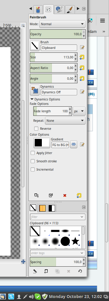

Still not working. My copied diagonal line is transparent. I dont know if its meant to be?
Here is two pictures one of the transparent copied diagonal line the other of my brush settings.
The brush is "transparent" just to show the outline so that you can see where the line will be painted. Once you click the line is painted with the foreground colour (currently black).
