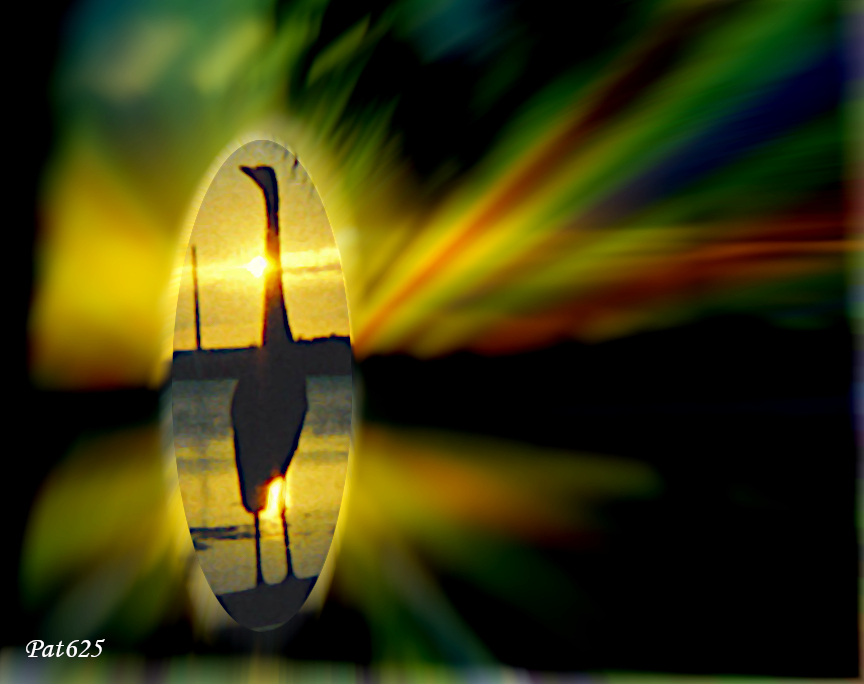

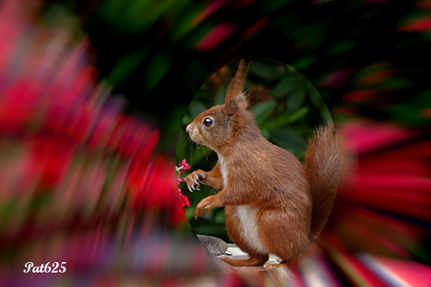

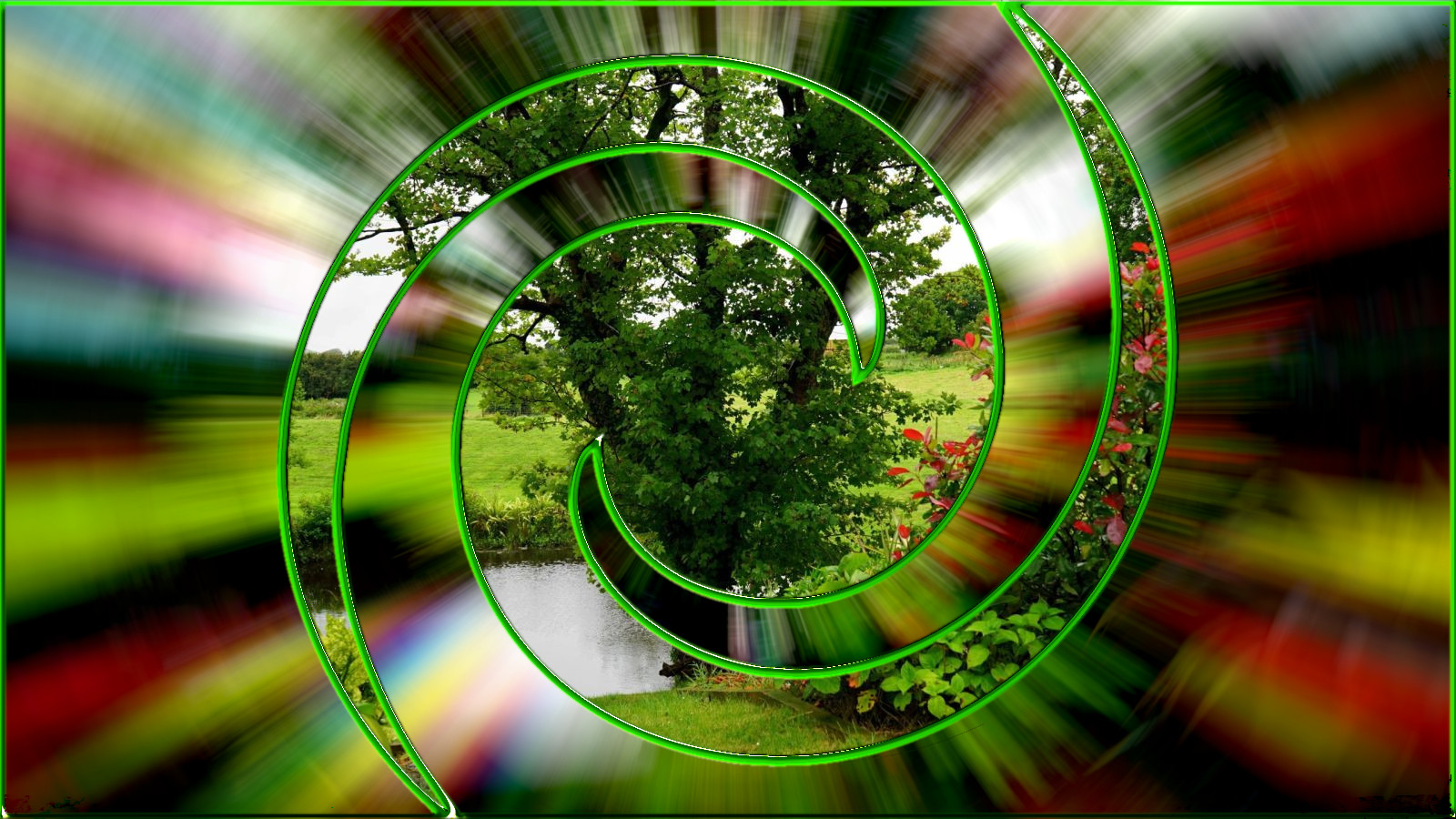

Today, Gimp is behaving better. I was able to complete some images.
Dinasset, I may be doing something wrong, but I could not use greater than 1.0 on Circular Motion Blur.
