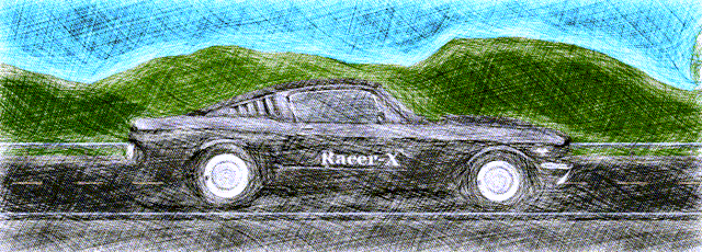

Here's one of my old animations converted using G'mic's "Sketch" filter. It was all done within G'mic and took just a few seconds.

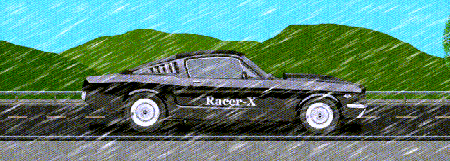

"Rain & Snow" filter applied.

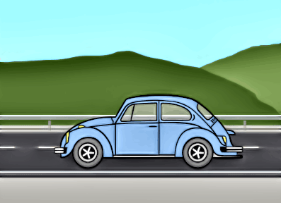

A first try with the old Beetle:

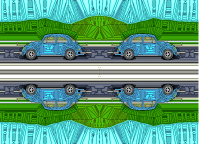

With illustrationlook or psyglass filters:

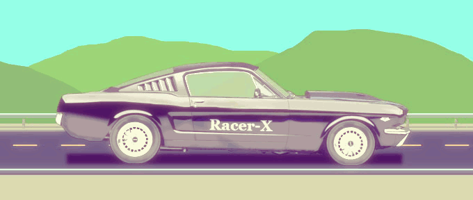

That's cool teapot. Here's a Vintage style filter.
