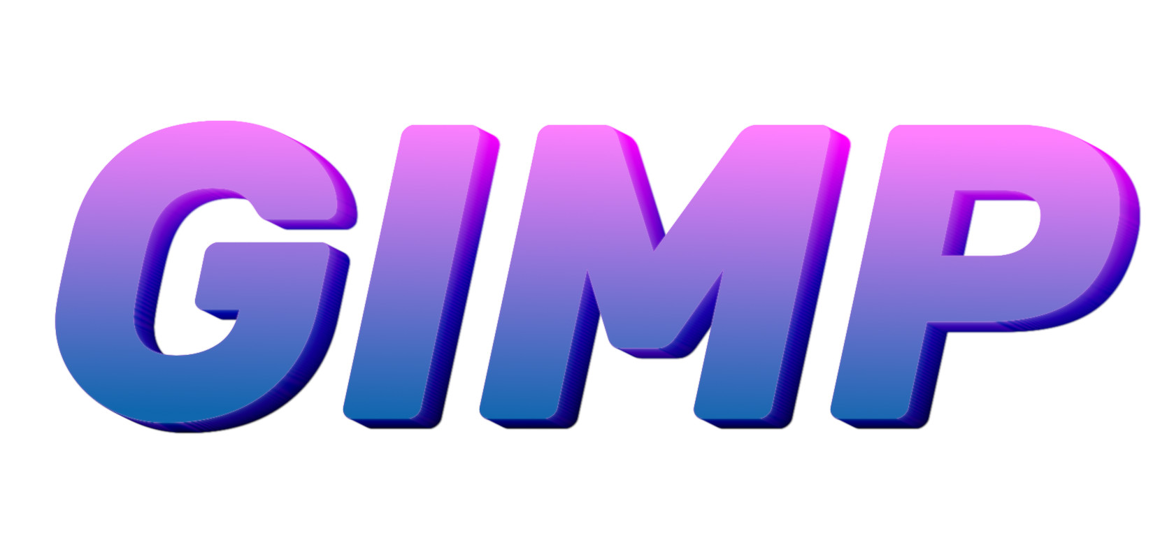

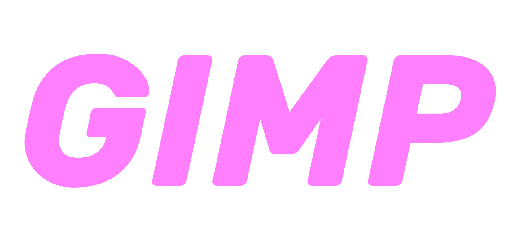

Use the text tool to add a caption to a new Gimp image as a text layer:

Now you can use the image with the Custom Font Faux 3D.
Link to Faux 3D plug-in on GimpLearn
Open the plug-in and choose the options that you require. Click on OK and that's it.
