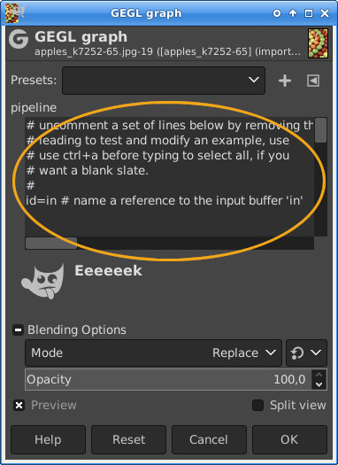

1) First steps:
  • Open an image
  • Go to "Filters->Generic->GEGL graph
  • Click the "pipeline" box
  • Hit "ctrl-a" and the "delete" key
  • Write anything (for example, "sdfg")
  • ...to be continued in the next post...

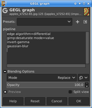

3) How to chain multiple effects:
You simply list all the effects each in one line like this:
Note: You don't have to put them into multiple lines. You may put them into a single line but separated by spaces (It's just less clear ;)).
Note: We will see later that it's possible to get all intermediate stages back.
Have fun!

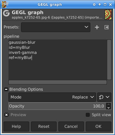

4) How to save and retrieve any intermediate stage:
To save an intermediate stage, simply add the special operation "id=chosenName" where the intermediate stage occurs.
For example:
To retrieve an intermediate stage, simply add the special operation "ref=nameOfStageToRetrieve" where you want it to come back.
For example:
This is a crazy example (since I discard "invert-gamma" result :shock:), but we will see useful examples later.
Have fun!
To be continued...
Photo to cartoon : https://github.com/cl4cnam/gimp_cartoon_plugin

This diagram is aimed to explain my last (crazy) example:
(EDIT: I've changed the diagram)
