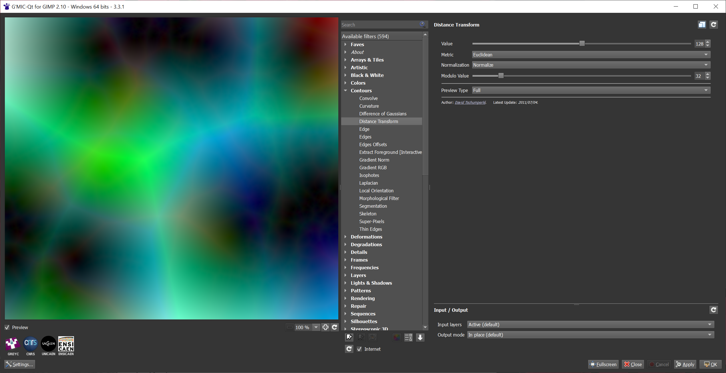

On the top layer run Distance transform per below:

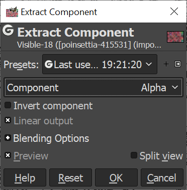

Now extract the Alpha channel to create the mask:

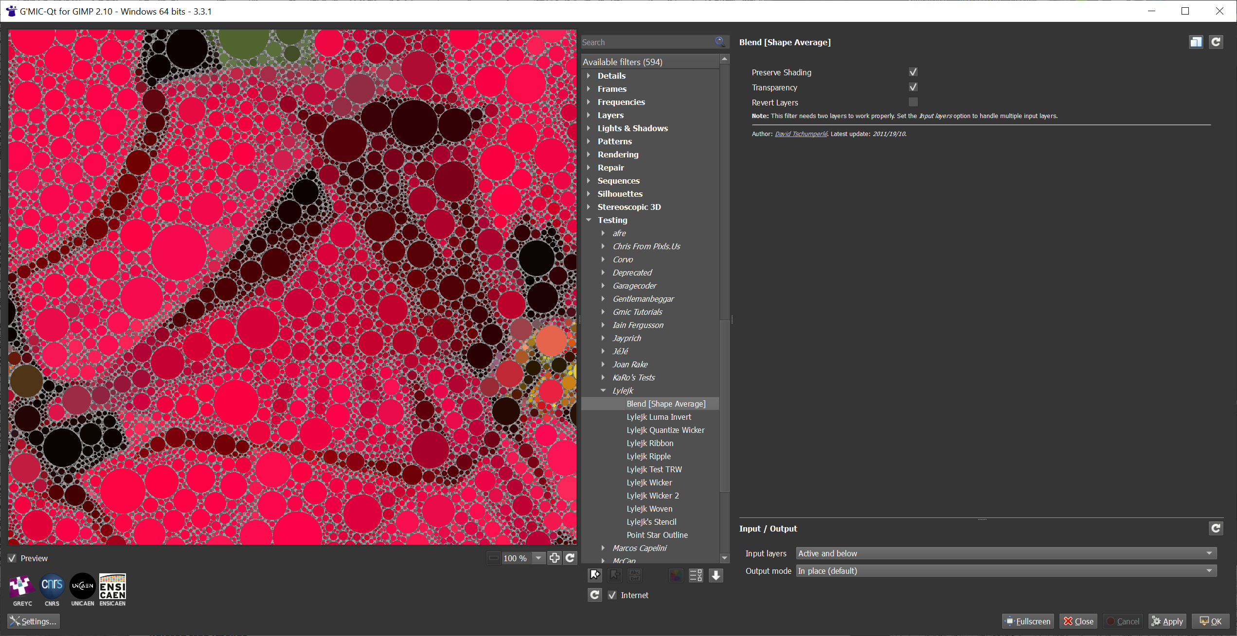

And finally Blend shape average with the base layer for the result:

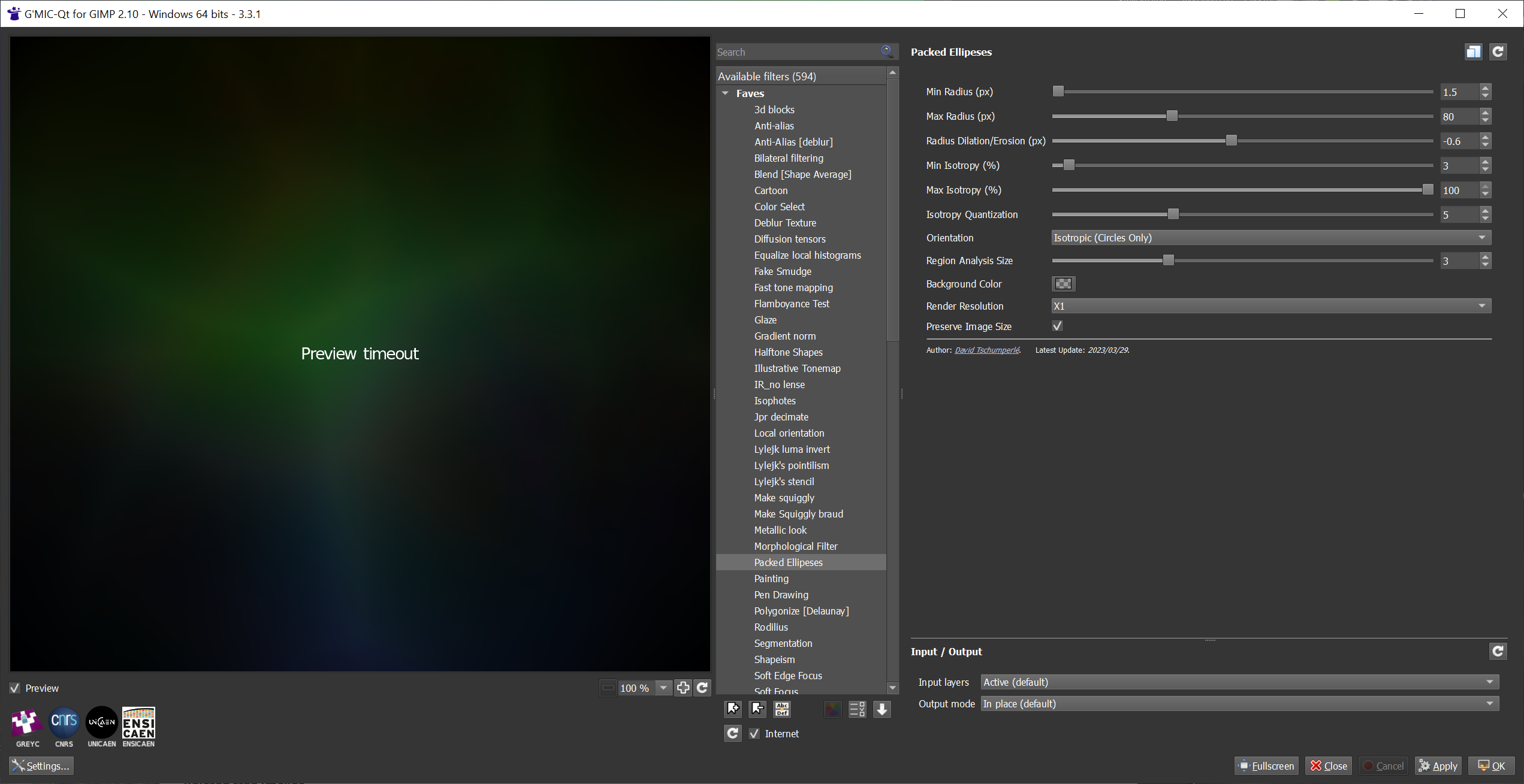

Whoops; I was doing so many circlism renders that I forgot I was using the favorite I created for the preset. Below's the actual path for this preset (with settings used in tut; note those settings are not the defaults for this preset). :)
