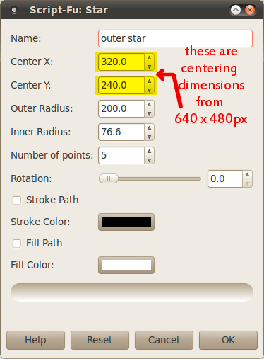

Ok, as I commented earlier, I wanted to give people the heads up on creating "near perfect" stars using the Script-fu - Shapes - Path option. I'm leaving out all the trig, and leaving you with the ratio in degrees between the outer radius and inner radius to maintain a "near perfect" star. To calculate, be sure to use the percentage sign on the calculator, failing to do so will not give you the correct answer. Whatever you determine your outer radius to be, to maintain a near perfect ratio, the inner radius must be 38.33% of that number:
(Outer) x (38.33%) = Inner radius (do not round up!)
For example in this video, I used 150 px outer x 38.33% and got 57.495. I entered 57.4 for inner radius. I didn't think I needed to explain everything, but just in case the new people are curious, let's take a look at that Shapes Path Star option menu:
If I want my star in exact center, I just halved the dimensions for the star path menu.
