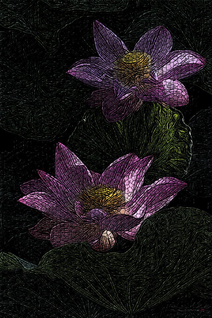

Used GMIC Engrave (default values) asking to create a new layer.
Used GIMP GEGL Mosaic (default values) on the background (original).
Set Engrave layer mode to Multiply.
Created a new layer from visible and set Mode to Screen.
Got this Outcome, which I like as combined effect.
If you like it too, repeat my steps.

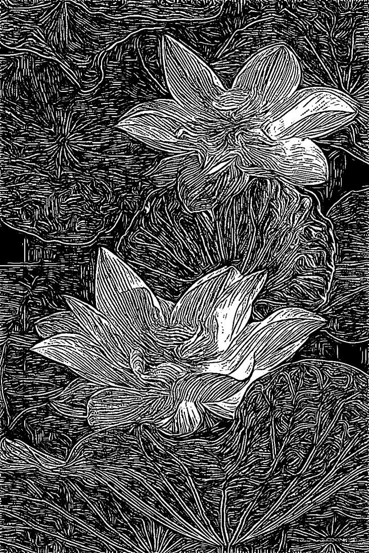

If someone follows these steps, (s)he should get a Gimp image made of 3 layers:
Bottom layer
Intermediate layer
Top layer
If you set this layer to Screen mode, you get the outcome shown on previous post.

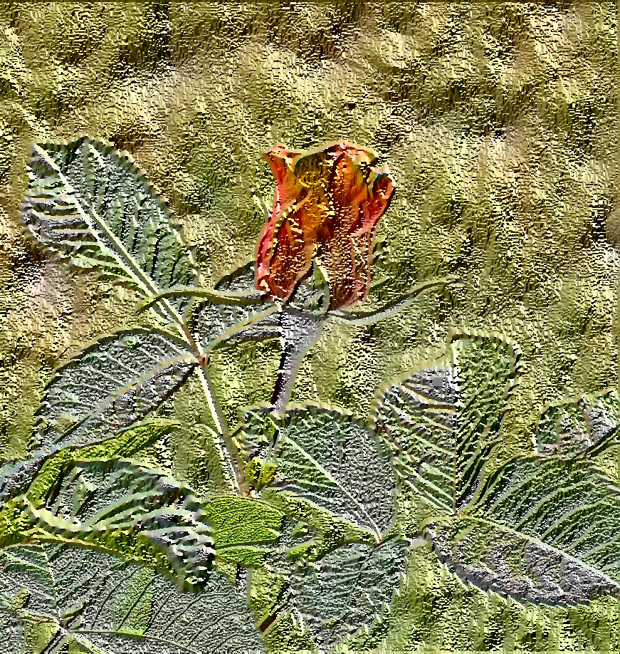

Taking Lyle's suggestion on using Local Orientation (only that), setting channels to YCbCr Luminance I got an outcome which may go into OMG Collections

 Post subject: Re: A simple play for everybody

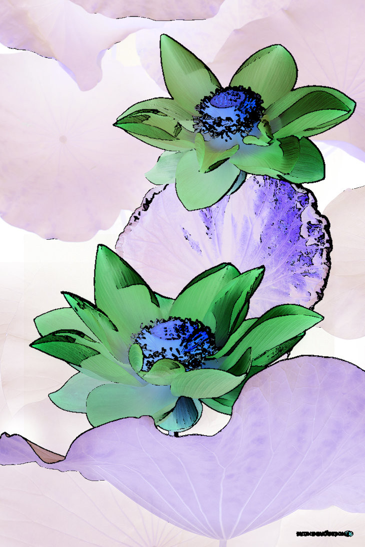

I did my simple experimentation, too.
My steps were: Gmic _ Edges (at a new layer) _ Gimp Colours _ Invert and set the layer at screen _ New from visible _
and applied Invert again on the upper layer.
002_by_duongquocdinh-d6nhic9%28original%29_Issa.jpg [ 223.09 KiB | Viewed 3165 times ]
