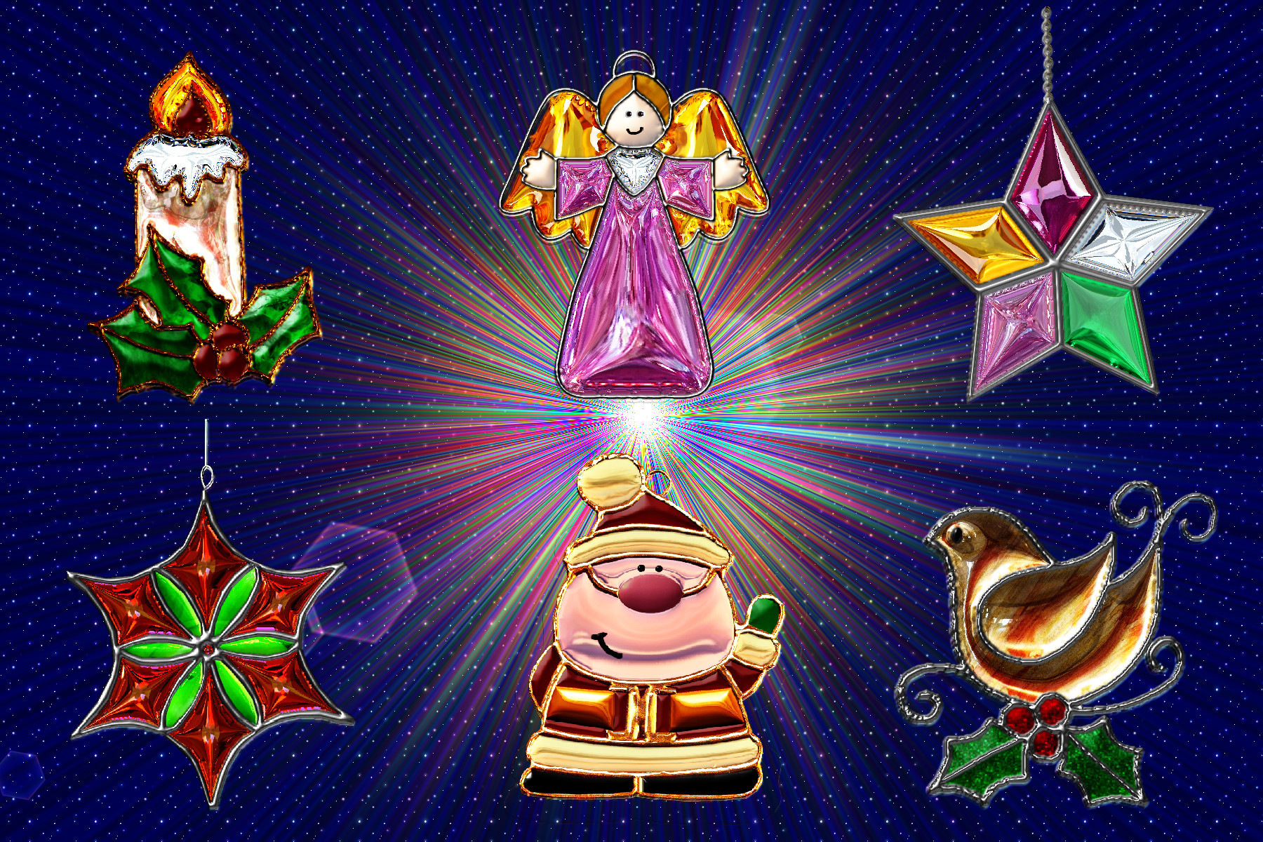

I finished the set I was doing. It sounds to Christmas hehehe. I add the frames in zip, just in case someone likes to do any variation. :)

those are beautiful. How do you keep the edges of the glass part from getting smaller when you run the filter? I always seem to have some blank areas between the filtered part and the outlines.

Thanks 2-Ton, it happens sometimes, not always in my case. When it happens I select the gap a little bigger. The frame is set on the upper layer and cover the possible little gaps. :)
