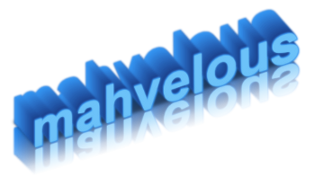

I sort of have a tutorial of how I did this on my blog here (just using a different orientation of the letters):
http://www.mahvin.com/?p=1159
Video here:
http://www.mahvin.com/?p=2221
To bypass my blog and go straight to YouTube:
http://www.youtube.com/watch?v=iSqfDYvaHFM
I actually had several people request their name in fire, as you see on the blog, to use for their iphone wallpaper.
I'd have to re-read the tutorial to see what I did differently for this. I know I had to link two text paths when using the perspective tool to create a top and bottom set for reflection purposes. I also used Colors - Curves to smooth out the jaggedness of the block lettering.
If I get a lot of requests I'll consider making a new tutorial just for this. There is only a limit of how large you can make your brush (512 x 512) using the copy/paste method, so that is definitely something you need to consider. Otherwise you will need to create a large animated brush.

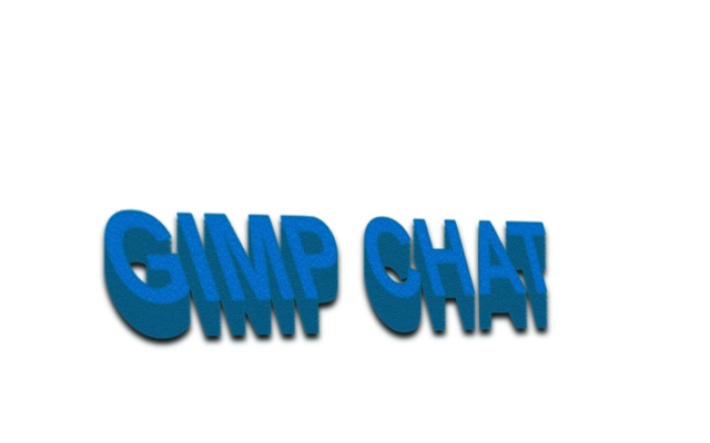

This is fun. I didn't make a brush, I just copied my text to the clipboard. Then, instead of the airbrush I used a regular paint brush.
 Post subject: Re: Pseudo 3D Block Text Made Entirely in GIMP
PostPosted: Sat Feb 12, 2011 11:22 pm  (#8)
:) Copy and paste works up to 512 x 512px. That's the way I do it, unless I need big text.

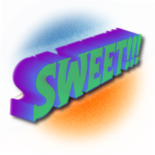

I did this using a path and stroked the path with the paint brush.

Another stroked text version. (quick and dirty)
My Sigs = My Photos
PostPosted: Sun Feb 13, 2011 9:35 pm  (#11)
MY EYES, MY EYES! :) I play with those all the time. I wish the flow of sharp letters wouldn't end up with corner stagger. I've tried all kinds of different ways to counter it, but haven't found the method yet. Outside of boxing it in with paths, of course.

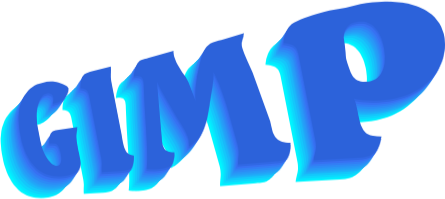

I'm still playing with it and having fun. Here's one for Valentine's day.

The problem I've been having is that there is always a gap between layers, even setting the brush spacing to 1.0 (minimum). I end up duplicating the layer and moving it 1 pixel vertical and 1 pixel horizontal. I have to do this several times to fill the gaps.
My Sigs = My Photos
PostPosted: Mon Feb 14, 2011 3:14 pm  (#15)
Try cropping the text you use for the brush so that there's no space around it.
