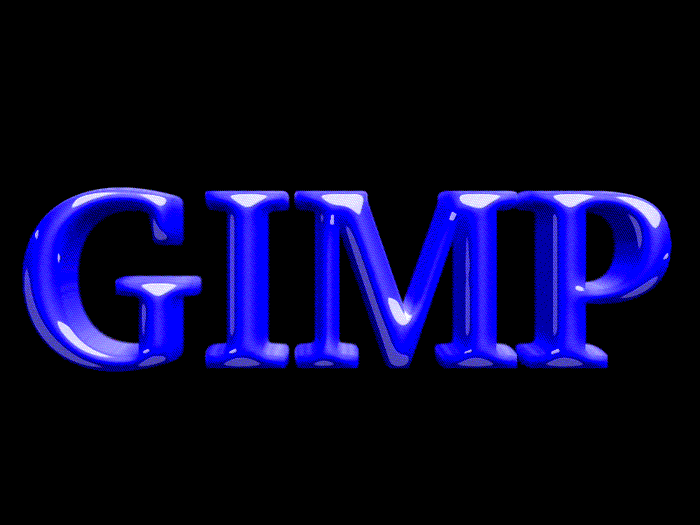

Guess how I did it.

PostPosted: Tue Jun 11, 2019 4:56 am  (#3)
Kaleidoscope and a lot of blur?

I used G'MIC > deformations > random (incrementally on layers.)
Then used motion blur on the deformations.
Tweaked a bit with fade out.
Comes close :)

My guess, by the looks of those sharp edges in the .gif is G'mic->Cubism.
Create few copies of the original. In the first animation frame use 1 iteration, and so on.
It will create a vanishing effect but you probably need to use the other parameters too (didn't test yet).
Maybe some radial or zoom blur in the end frames?

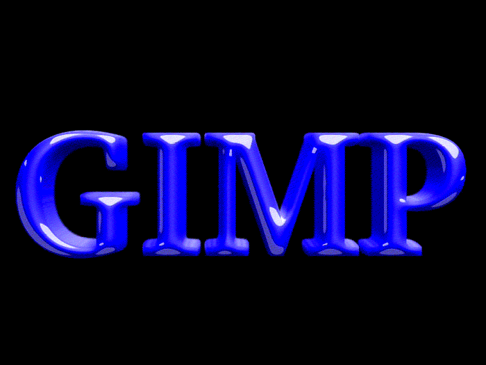

I did this one in a video editor using a PNG made in Gimp. I could have added more effects, but you get the idea.

Made 3, or 4 copies of the original layer.
G'mic Cubism, first animation layer 1 iteration, 2nd layer 2 iterations, 3rd layer 3, 4th layer 4 iterations.
Some minor changes in density, thickness and more smoothing towards the end frames.
Rest 4 animation layers were just repeated with the last setting, ctrl+F. And last is pause layer using same BG layer.
That's exactly how I did it.
Minus the blur.

Wohoo, I haven't won anything in ages. Feels like lottery jack pot I'm gonna have ice cream cone and coffee with Wilber.
After trying out myself, I figured the smoothness slider is helpful and blur is not needed
I think it was somewhere in the back of my brain that cubism can do it, had one setting saved as favourite.
Some animation programs have effect called scatter that looks very similar.

Not bad for all Gimp/G'mic effect. Yes shatter filter is what I used in my example. I added some light rays to add to the effect...

@Tas_mania, I used Aviutl for the animation effect. It has the shatter filter and many more. Sorry for the confusion.
Aviutl is still my go-to program for most animated effects. Its one of the very few reasons I still have a Win7 VM on my system. It can run under wine, but wine is a PIA to keep up. I no longer use wine.

I'm posting the project files, if you want to see how it works. Just open the "explode.aup" project file in aviutl. You can play around with the settings such as debris size, gravity and so on. You can swap out the image used by clicking on the "Reference" button in the image properties window.
Have fun...
explode_image.zip [147.12 KiB]
Downloaded 222 times
