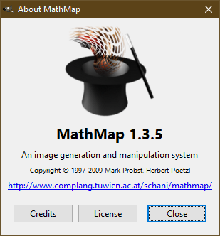

Mathmap works with GIMP 2.10x and in Win10 64bit. I believe Graechen shared this with us a while back but too lazy (got off a 10 hour shift just a bit over 2 hours ago and it's late) to find that thread but it's here. Not sure if it was compiled for 32-bit or 64-bit ability, but either would work anyway. Just do some sleuthing. I have the version as shown; probably not the lastest version but it works fine for all my droste madness that I share here. :)

My version (last version 1.3.5) have it. It's not showing at the top of the filters because I scrolled down, but it's there.
