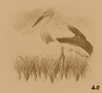

In our next example 4.0, we have a photo that could have been a black and white
at one time, but has just faded over the years.
There are a couple different ways to return this back into a good black and
white image. For this illustration I’m going to show you how to use the levels option; but this
time where are going to adjust each of the 3-color channel to make each one equal to the other two, thus
restoring it back to a nice black and white looking image again. And here is what I did.
Now as you can see there is a slight tint to the image left from the Levels corrections,
This can vary from program-to-program functions of how they created the levels tool. In Gimp they
created a way to remove this (FX) in the process. To fix this...
Go to Main Tool Bar >Layer > New from Visible
Then Layer> (Shift + Shift + D) Duplicate Layer
Chane the top layer blending mode to HSL Color with the Opacity at 50%
Next go to, Colors > Invert
And then right click your layers palette and Merge Visible Layers > OK.
And you're all done.

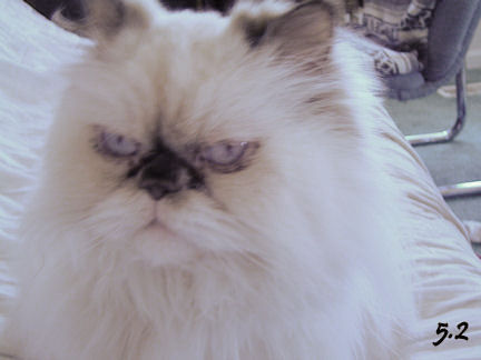

Here we have a image with the camera setting was not set to the correct setting to take
a good picture. My bad!, So with example 5.2 here I will should how to fix it.

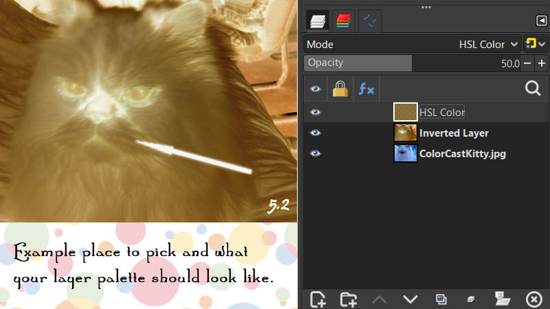

Next using the Color Picker tool to change the foreground color, select an area from the
top layer, an area that should be white on background layer that is underneath the top
layer to properly fix the color cast. (Selected color should not be solid black).
Now Layer> New Layer >
Change the Blending mode to HSL COLOR, Opacity at 50%,
fill with foreground color and then click OK.
See next image for help. Where to select and what you layer palette should look like now.
Now for the Magic.
Delete the middle layer and select the top Layer
Goto > Layer > Merge Down
As I noted before, if your adjustment for the top layer is set at
50% and it don't fix the problem, you have not correctly selected the white
balance area and you are slightly off target. This doesn’t mean you can’t fix the white
balance with it. It’s just giving you clues about the sample color
you selected doesn’t make all 3-color channel equal in your image
and you'll have to try again.
In my example I used here, I selected my color sample under the
kitty nose and to the right, where the arrow is pointing in the example image,
not behind the kitty ear where it is washed out.

1. Duplicate the image Layer
2. Invert the Color
3. Use the Color Picker Tool to get my color. (The X is my choice)
4. Created my new HSL Color layer and fill with my selected color at 50% opacity.
