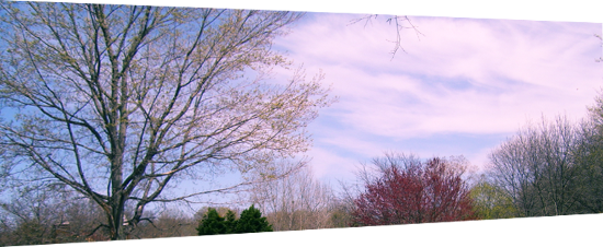

Is there any way to get the edges less jaggy without cropping?

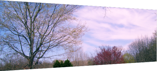

I just used the Perspective tool on this one.
File comment: Perspective Tool only
