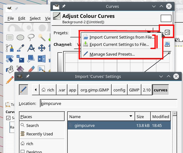

I am pleased you have something working, but correctly goes like this.
The presets go in the filters folder.
An edited curve can be exported to the curves folder and imported at some later date.
Thank you. :) Next time I will just place the files in the filters, rather than adding them manually to the file itself and see how that works.
