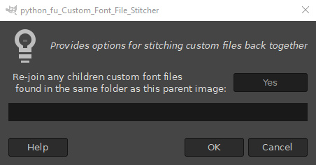

When you have installed the plug-in fire up Gimp.
Open the parent custom font file 'Happy-Donuts_Caps_Striples.xcf' from the File menu:
File>>Open...
and navigate to the file location.
After the file has loaded and you can see the custom font layers in the layer stack, call up the plug-in from its location:
Filters>Custom Fonts>Constructing Tools>Custom Font File Stitcher...
Click on 'OK' and that should be it. If it works then great - otherwise boo-hoo.

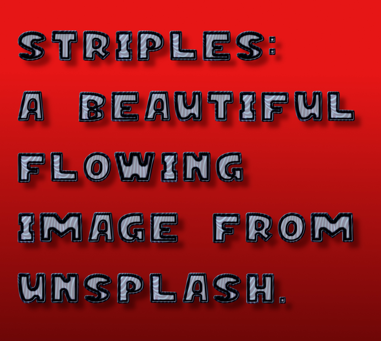

An example of how the custom font should look.

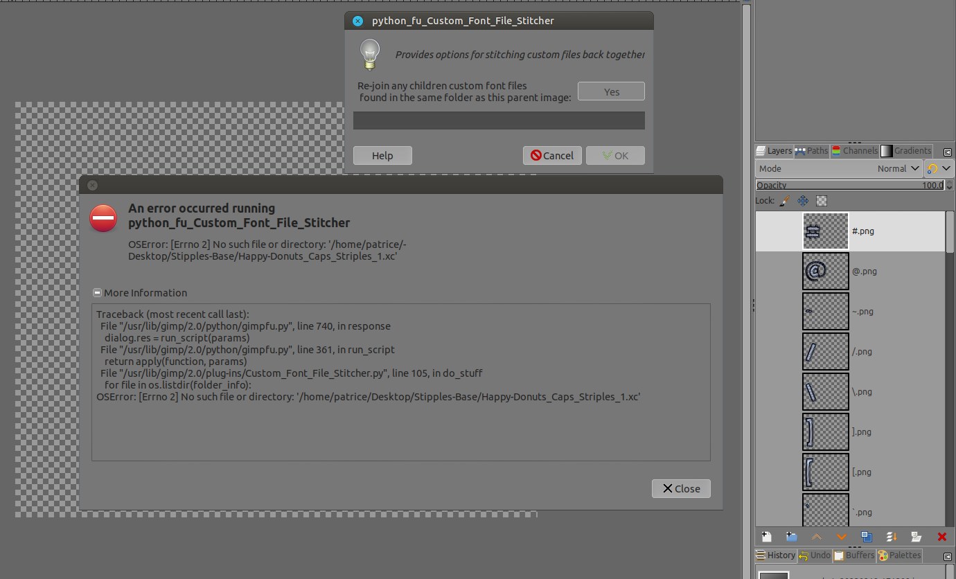

Tried on Linux Mint 20.1 GIMP 2.10.28 PPA Install:
Got an error:
  File "/usr/lib/gimp/2.0/python/gimpfu.py", line 740, in response
  File "/usr/lib/gimp/2.0/python/gimpfu.py", line 361, in run_script
  File "/home/xxx/.config/GIMP/2.10/plug-ins/Custom_Font_File_Stitcher.py", line 105, in do_stuff
    for file in os.listdir(folder_info):
OSError: [Errno 2] Datei oder Verzeichnis nicht gefunden: '/tmp/Happy-Donuts_Caps_Striples.xc'
Last Line: The filename says .xc instead of .xcf
Is that where it goes wrong?
PS.: Files were put into location:
/tmp which of course exists.
Regards
nelo

Same here, same problem, I'm on Ubuntu-MATE 20.04 - GIMP 2.10.32, PPA from Panda Jim
I did put the 2 xcf in the same folder (the one I used to open the first xcf (written in the big screenshot)
It says ".xc" ... should not be ".xcf"? (all your files for this test have a proper .xcf ;) )
Patrice
