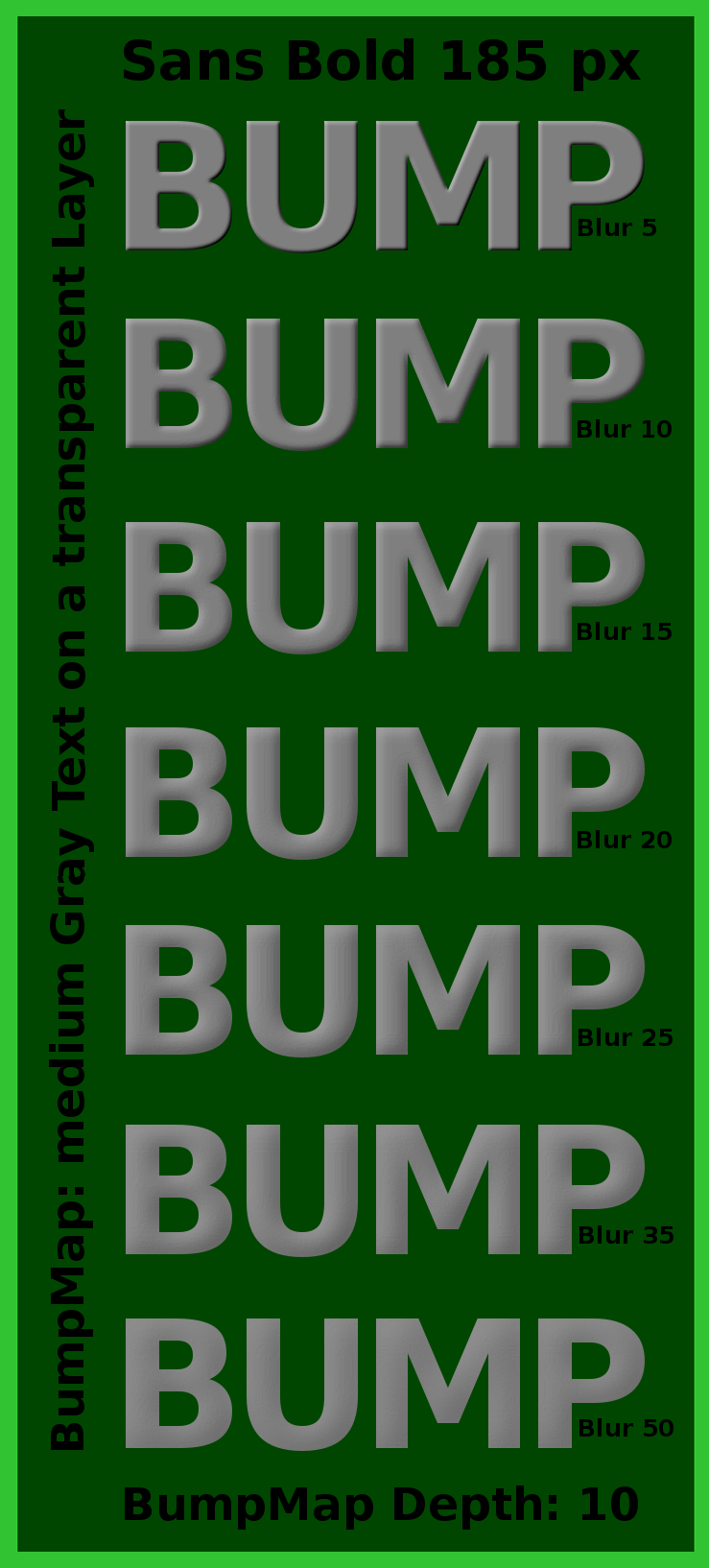

On my mission to understand how to make a bevel without a script, some people suggested bumpmapping and one thing i was always curious about is what different variations in the bumpmapping process actually do.
I made two experiments. They both show some interesting results, imo.
Here i used a bump map of medium grey on a transparent background, which is blurred more with each step.

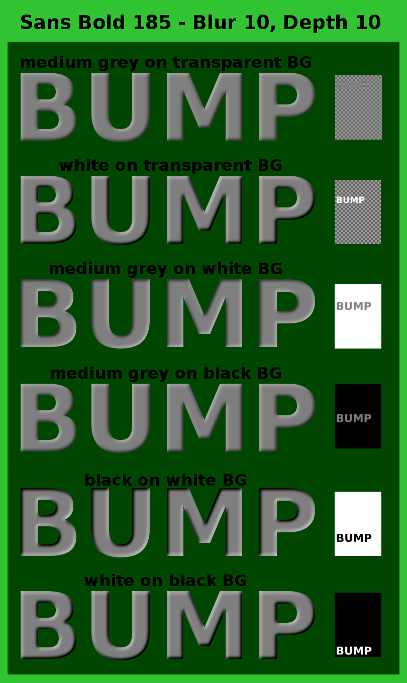

In the second experiment i used different color variation for my bumpmap, but blurred them all the same.
It doesnt work with a black blurred map on transparent BG

Good charts, they make it easier to understand how bump mapping works when visualized.
Thank you Esper.
I have experimented a lot with maps before, either bumping or displacing images, before I came up with these tutorials
All those charts are in my head since then.

now that the scientists of Gimp Labs have found out that bumpmapping with white text on a black BG gives the best result (and inverting the colors just inverts the "bevelled" edge), here is a new updated chart for all your bumpmapping needs:

esper: this is useful, thanks for sharing. but i want to object to your wording here:
"best" depends entirely on what effect you're after at the moment, doesn't it?
 Post subject: Re: BumpMapping [Gimp Science Labs]
PostPosted: Tue Jan 15, 2013 11:16 am  (#8)
Joined: Jul 17, 2012
Posts: 2769
Steeno: thats exactly what i was hoping for, thank you very much !
it appears to me, it gives the best contrast
if you want less, why not change the depth or the ambient ?
any suggestions how the wording could be changed for the better ?
what does grey do, that black doesnt ?
PostPosted: Tue Jan 15, 2013 11:23 am  (#9)
well, it's easier for me to change the effect by changing the colour than by changing some other parameter, at least in this case. i think maybe it would be better to say what you just said - white on black gives the best contrast.
PostPosted: Tue Jan 15, 2013 11:25 am  (#10)
Posts: 2769
i agree about the contrast, but then again, how do you know what kind of grey to choose for what you want to achieve ?
PostPosted: Tue Jan 15, 2013 11:58 am  (#11)
esper: hex code #888888, also known as "neutral grey" is my standard :).
PostPosted: Tue Jan 15, 2013 7:03 pm  (#12)
Posts: 2769
well yes, but what does that achieve in comparison to white on black ??
PostPosted: Tue Jan 15, 2013 7:44 pm  (#13)
Posts: 2769

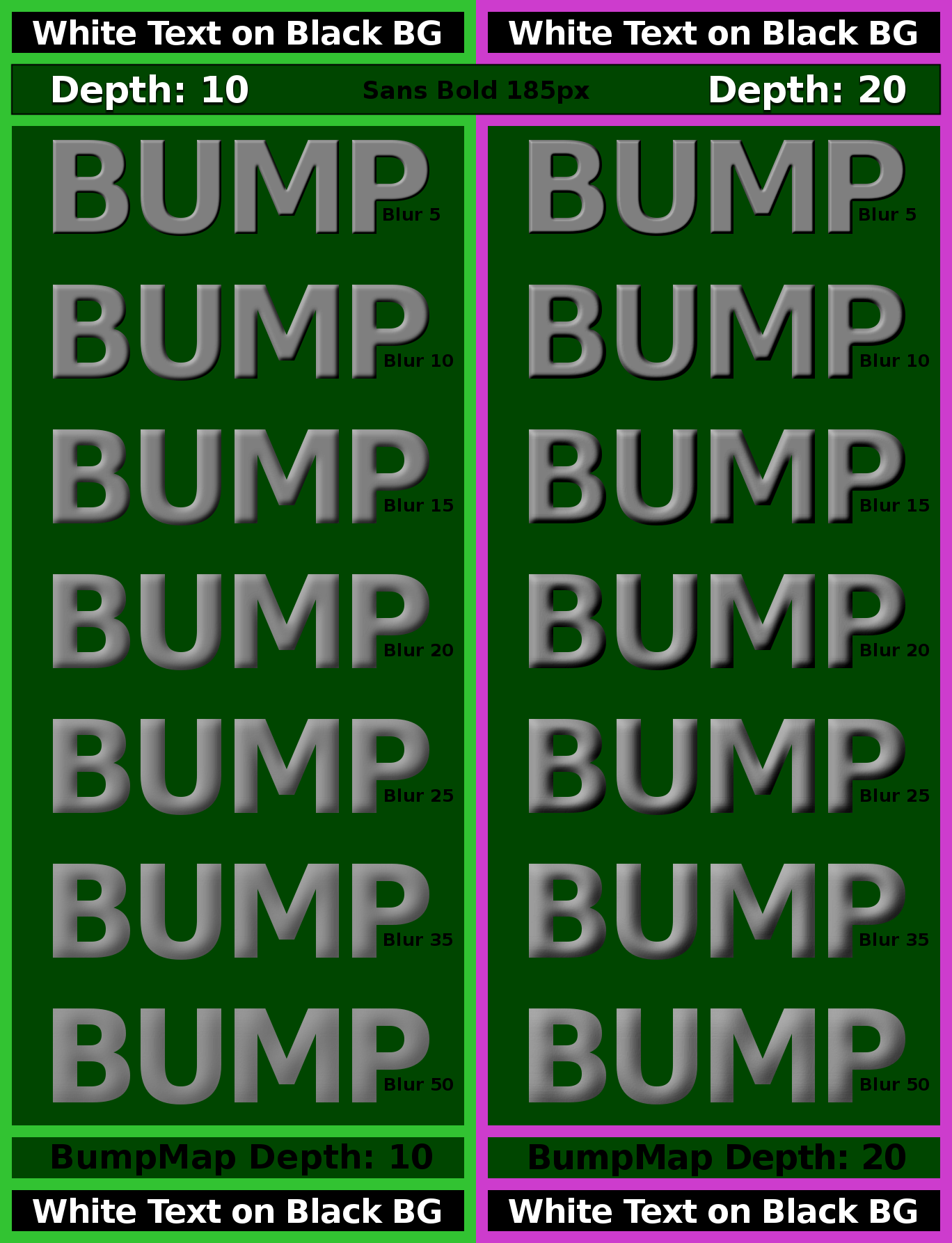

another chart, this time bumpmapped with a depth of 20 and combined with the depth 10 chart
PostPosted: Wed Jan 16, 2013 12:35 am  (#14)
esper: to be honest, i can't be sure exactly what, because i havent researched it thoroughly yet. what i know is that neutral grey on white gives a softer contrast than white on black (my guess is about similar to white on black with a depth of 2), so that's why i use it. instead of bumping with white on black and lowering depth with the slider, i bump with grey and get that soft look i'm after at once.
if i was to research it i think there are a lot of factors i would research, like:
1. exactly what depth on a white on black bump map would neutral #888888 on white correspond to?
2. would neutral grey on black give exactly the same effect?
3. would the value of the colour/colours i'm bumping make a difference?
i am a bit curious about all that, but i'm not curious enough to go through all the work of researching it.
