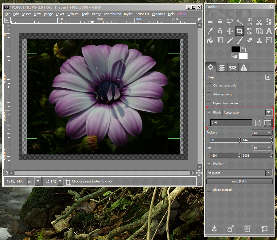

No maths required...
Use the Image>>Canvas Size to enlarge the canvas to 120%
Set the crop tool use use a fixed aspect ratio of 5:7
Drag the crop rectangle around to see where you need to add stuff, or crop stuff:
Kevin

They get cropped because they haven't got the same aspect ratio (width/height) as the paper. To create an image with the right aspect ratio, use the Crop tool, and in the Tool options set the "Fixed" selector to "Aspect ratio" and the entry field under it to W:H (for instance 7:5 for landscape orientation on 5x7 paper). Then when you use the tool the crop rectangle is constrained to the set aspect ratio.
Of course, the picture is cropped, but at least you picked the part to keep. You can also increase the canvas size (with your picture centered), and do the same, the difference being that this will add space where necessary. Then export to JPG (this will add a default background to fill the transparency).
