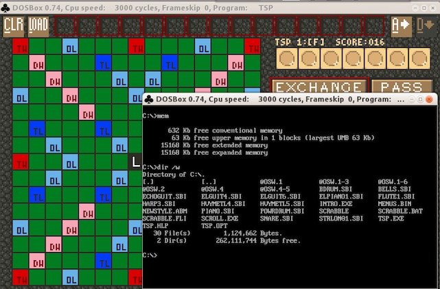

Only ever used dosbox for this old scrabble and then only in linux
For the memory I have a dosbox-0.74.conf file which contains the section.
[dos]
# xms: Enable XMS support.
# ems: Enable EMS support.
# umb: Enable UMB support.
# keyboardlayout: Language code of the keyboard layout (or none).
xms=true
ems=true
umb=true
That gives memory and file values as:
Zero disk space? Are you trying to run off a CD?

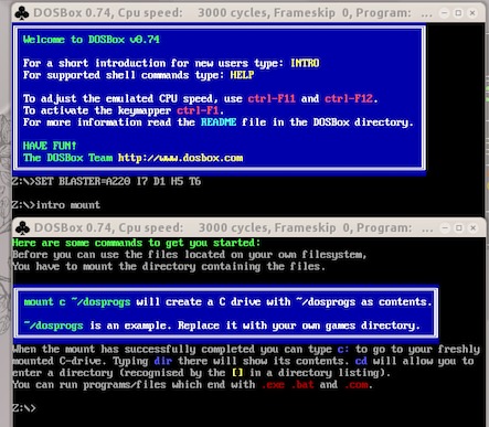

Have you mounted the game folder as per the very sparce dosbox help?
best of luck ;)
