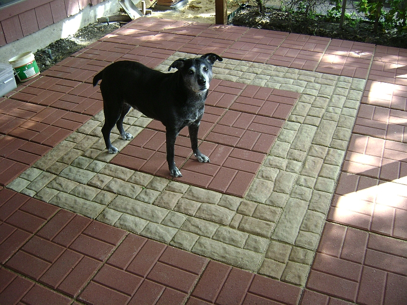

I have not had much time of late to allocate to the Metal Wurx series due to an on going project. When I had my foundation repaired last Summer, several holes were drilled for the piers around my patio area. The problem was, they piled all the dirt in the middle and when they lifted my foundation (9 1/2") it also raised one end of my patio. That night my wife and I were watching TV and heard what sounded like a sonic boom. It scared the hell out of us and we thought part of the house was collapsing. When we finally looked outside we saw the patio broken in both directions from the weight of the dirt.
To make a long story even longer, we had to jackhammer up the entire patio and haul off the debris to the dump ourselves. (not an easy task for a 62 year old man and his wife) We and our dog endured an entire year and the muddy seasons, saving up enough money to replace it. We had plenty of time to think about it and finally decided to not pour concrete since it was going to cost over $1,000.00 due to the minimum order (6 yards) when we only needed 1 1/2 yards. In the process, I ended up replacing the patio cover as well. In retrospect, I am really glad we decided on pavers in lieu of plain concrete. It was a labor of love that almost killed us, especially my poor back, but I think it was well worth it!
All that's left is to modify the downspout and hang a light fixture. Now I can get back to more important things like GIMP. :mrgreen:

I left out the most important part.....we also have the supervisor's approval!

So how did you lay it down? I guess what I am asking is how you made the patio's base level?

If you go to Lowe's or Home Depot all the information is in the brochures for how to do it. I own a company called Frame-Rite Construction so I've been building and remodeling, and landscaping for years. I actually cheated and used Portland cement tilled into the soil, compacted it and wet it down and let it set-up for a couple of days. The decomposed granite goes down next (paver base) and I only had to use about 2" instead of the regular 4" to 6" because I stabilized the soil first with the Portland cement. (cheaper).
The 1" pipes are laid on top after the base is down and compacted to the apropriate height and then sand is laid on top. the pipes serve as guides so you can use a 2x4 to "screed" the sand so the depth is uniform, then just remove the pipes and fill in carefully. I use a 14" trowel just like I was finishing cement to get it smooth and even where the pipes were. The rest is carefully laying down the pavers and using spacers. When you are finished, use Polymeric paver sand in the joints and spray lightly with a fine mist of water several times. Polymeric sand sets up kind of like rubber when exposed to water so you get a semi-permanent joint that is very resistant to UV light and weeds. Works great and is really worth the money.
As far as getting everything flat and level, there is actually 1" of falloff away from the house which is accomplished by using stringlines and a line level. Once your strings are in place you can use a piece of wood with marks on it for each layer to get the depth the same all over and maintain the slight slope you want. It would be extremely difficult and would require an incredibly talented eye to guess at it and get it to look even close to right without the strings to guide you.
Sorry to go off, but you did ask how I did it.
