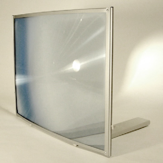

:hehe That would be quite a drive.
Maybe you can get one of these to place in front of your monitor...
