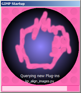

If your splash image has transparency, then your theme will show through:
Kevin
Kevin
Very cool. But sometimes my images that have transparency use a white bg. They are all the same extension by the way "PNG". :)

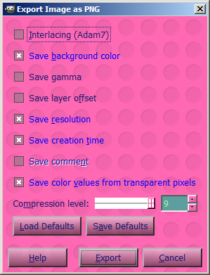

On the "problem" ones I'd check the export settings. These are the settings for my example above:
Kevin
Kevin
Oh yes i bet you are correct. :)
