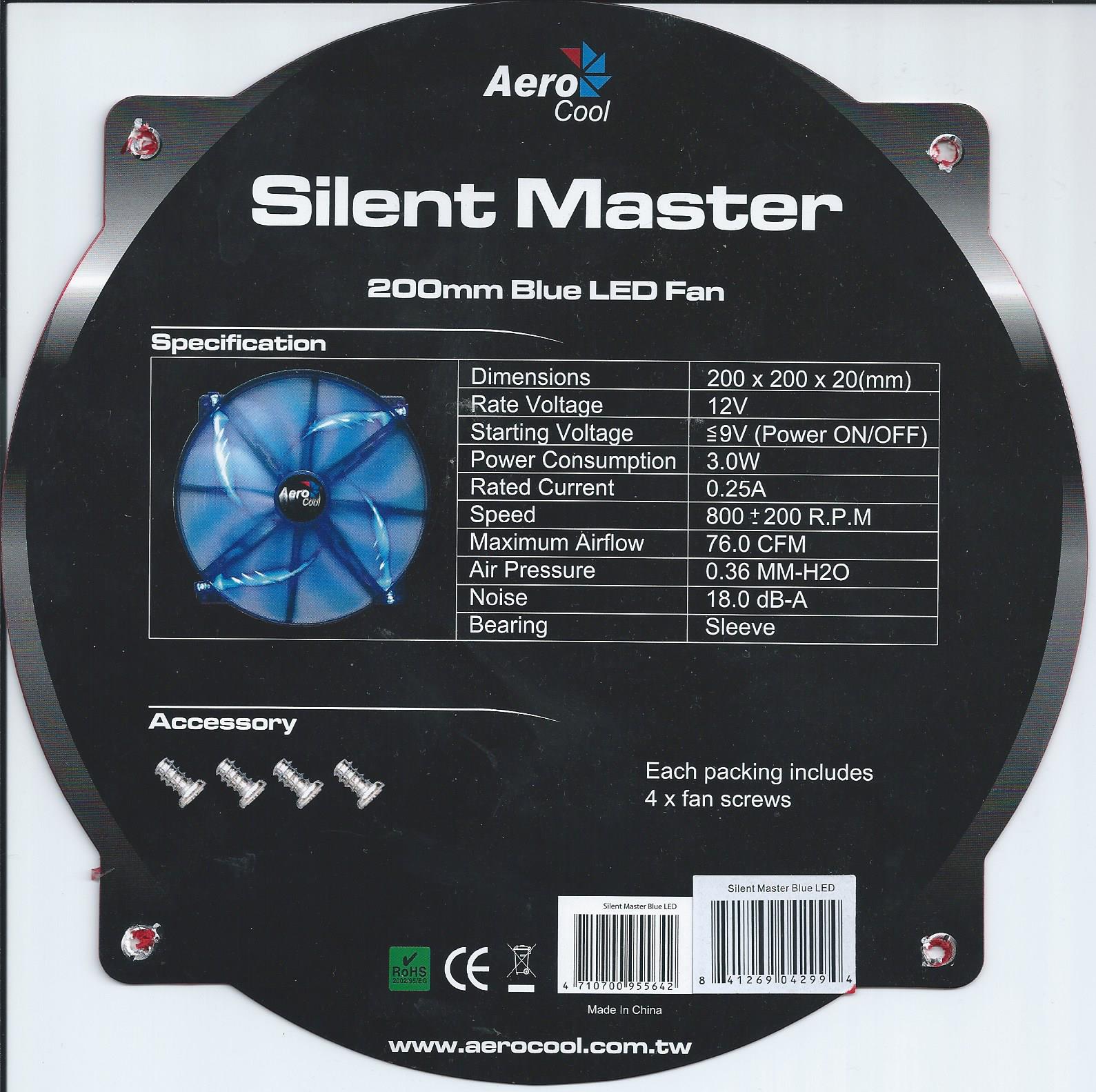

I just finished cutting a huge hole out of my side panel to install an AeroCool Silent Master 200MM fan. I wired the fan so I could plug it into a wall socket or powerstrip, using a 12V/0.25A power adapter I picked up at my local goodwill for 59¢. The fan is whisper quiet and dropped my temps a good 7-10° C.
I don't own a camera of any kind, or I would have taken photos to show you guys.
The scanned image below was used as a template for the side panel hole.
Fan Specs

The CFM (cubic feet per minute) airflow of this fan is only 76.0 at 800 R.P.M., but I have 3 other fans I put on the case as well. I could have purchased a fan with a higher CFM, but it would also have a higher dB (decibel) rating and wouldn't be as quiet as this new fan I just installed. Any db rating above 20.0 is concerned loud and this fan has a rating of 18.0.
My computer case now has very good positive airflow, which is what I wanted to accomplish.

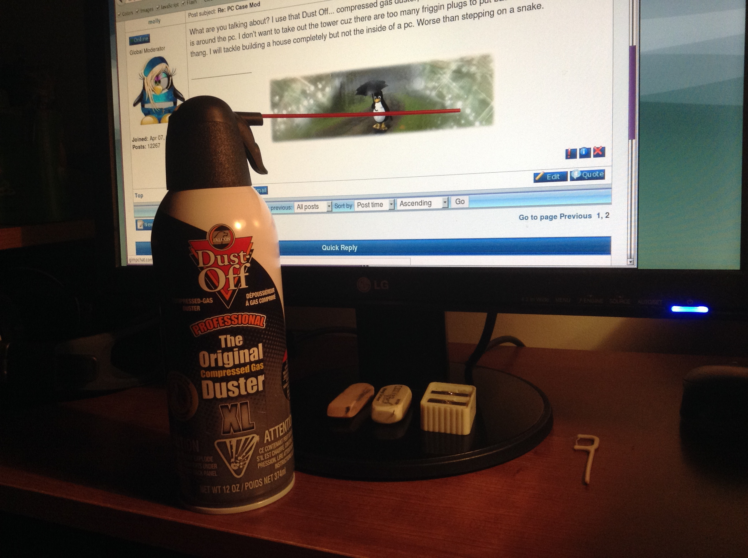

What are you talking about? I use that Dust Off... compressed gas duster, then I take my vac hose and suck any up that is around the pc. I don't want to take out the tower cuz there are too many friggin plugs to put back in. Another scary thang. I will tackle building a house completely but not the inside of a pc. Worse than stepping on a snake.

did you see my duster I posted above?
No, I'll look now...
I can't find any "duster"? :(
Sorry... Yes I see it now. :oops:
I have an electric duster called "DataVac". No more buying cans of compressed air for me.
I blow out my machine at least once a week using the DataVac, it's very dusty here in Arizona.

Temperatures haven't really gone out of the norm. Between 45-55c, but now I'm down to 32-40c, just with the addition of this new fan.
