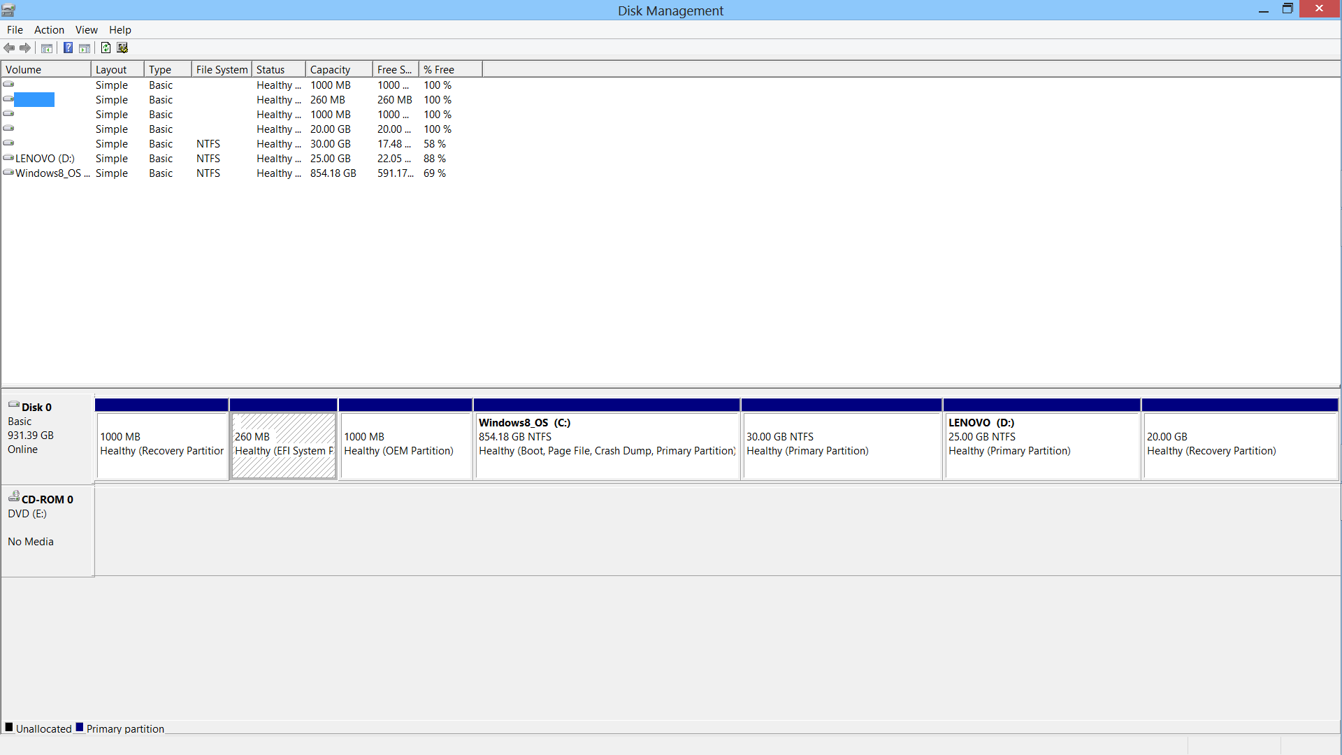

Willy wrote:
Well when I first came back that day I tried to install Ubuntu on my computer again by booting from USB on startup. Tried a few times and I couldn't figure out how. After searching around on info about my computer, the way it is setup, installing Ubuntu might not even be that easy as there is apparently already 4 partitions on the hard drive (some old limitation)
To find out what's on your partitions.
(I don't have Win8 but it should have the following)
Control Panel | Administrative Tools | Computer Management | Disk Management
Give it a minute, it will display details of each partition.
A screen shot might be helpful for anyone who's troubleshooting.

I don't want to dual boot, as I just well don't :lol
don't want to deal with win8, but still want the option to use it if I ever need to.
and as for that screenshot.
Okay tux, I may just wait and see what else comes of this thread...as I really don't want to break my computer

Wow Willy how much RAM does that machine have :lol
8GB lol...I intend to eventually upgrade to 16 even though it's not officially supported it's been done enough times. Why is it listed as something weird?

YAFU wrote:
I'm not sure that the UEFI is your problem and I have not had to install anything in EFI mode, but just in case I say that you should set your bios to boot in EFI mode. Maybe this will help:
https://help.ubuntu.com/community/UEFI
http://askubuntu.com/questions/91484/ho ... m-efi-uefi
http://www.ambitious-vision.net/en/fedo ... fi-how-to/
Highly recommended, make a backup of all your important data, if possible on an external drive.
Please, you do not give up and do not make Microsoft achieves its goal with UEFI... :) :pengy
I don't intend to let them win!
those first two links honestly kind of scare me away from this because I don't want to much up my computer :/
I'm almost wondering if I could make a live CD to install windows on here, and then do a full wipe and have Ubuntu boot off the SSD and have windows as my second OS, just as it would be if I installed them in reverse order. Would this solve the UEFI issues? And any of the other acronyms mentioned in this thread? (a lot of this is over my head sorry)
