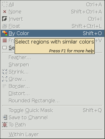

If I read the GIMP docs right on this: http://docs.gimp.org/2.8/en/gimp-file-create.html then I can see why you would have a problem as the Delay is applied at the wrong time.
Here on lowly Windose, I can select to capture a single window and set the delay to something. Select which window I want using the cross cursor, then the delay is applied and the capture done, tool tips and all:
Kevin

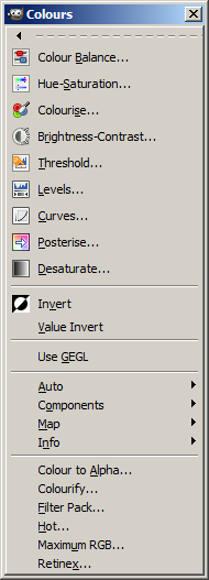

I guess you're asking this in general terms rather than GIMP specific menus, where you can use the "tear-offs" to get separate windows when accessing the menus from the right-click(context) menu:
