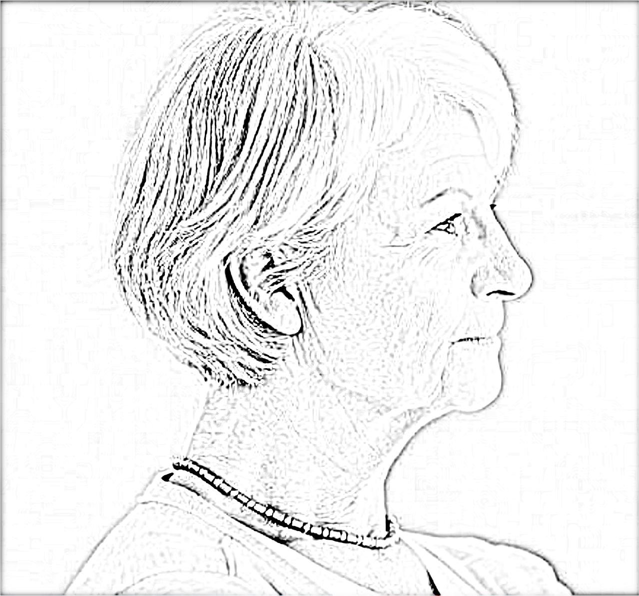

I just started using GIMP. I did this to a photo, how did I do it? I forget. HELP!!

For something close try:
-desaturate
-duplicate layer
-gaussian blur 6.5 on top layer
-divide mode
 Post subject: Re: Photo enhancement
PostPosted: Wed Nov 25, 2020 2:28 pm  (#3)
Joined: Nov 24, 2020
Posts: 4
Thanks. I know I didn't do those things. It had to be simpler than that. I'll try them though.

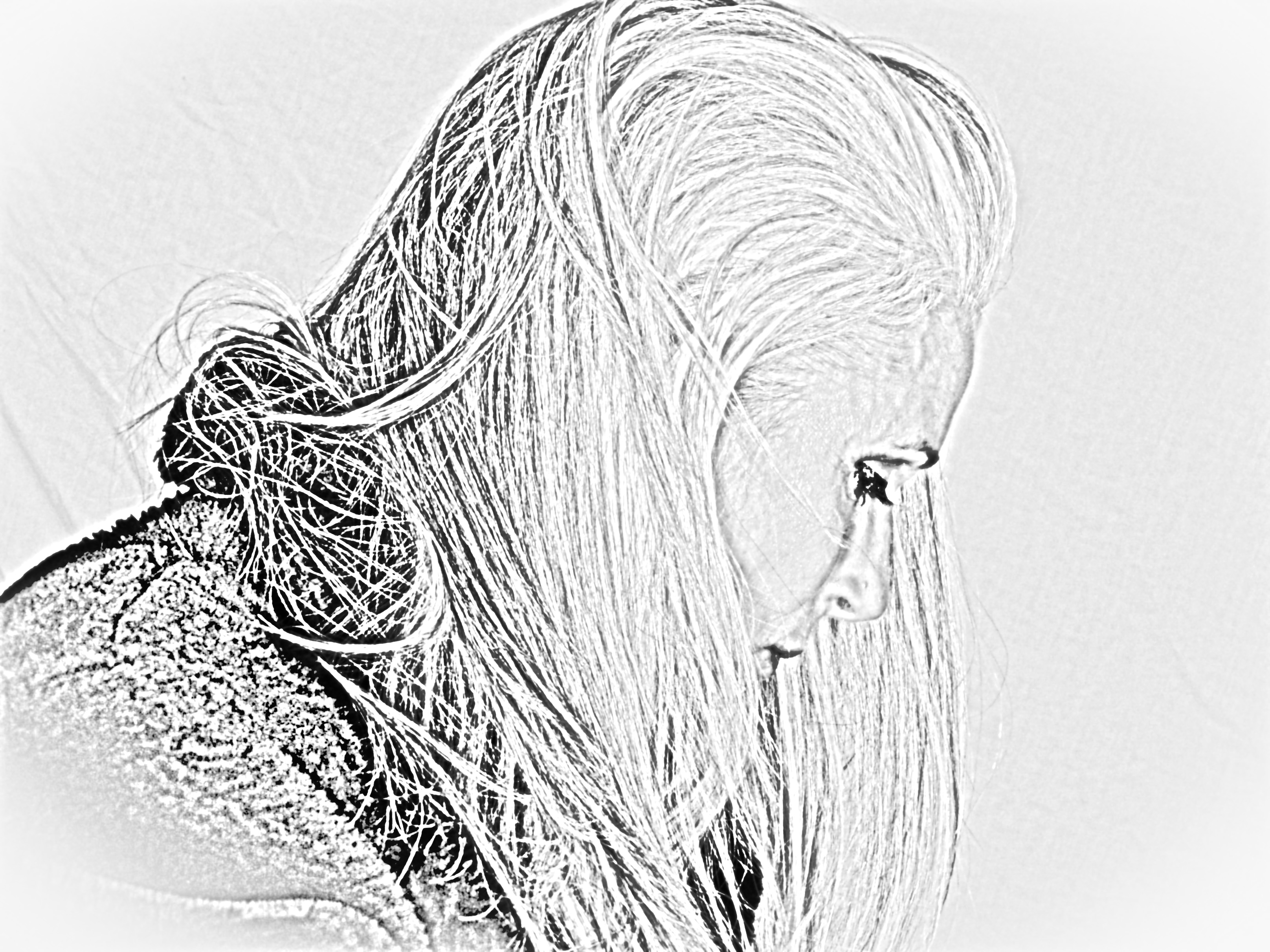

There is a python plug-in by TIM called 'Picture to Line Art' that can deliver similar results. The layers produced from the plug-in are retained in the result, so it also allows you to tweak that outcome. Here is an example.
