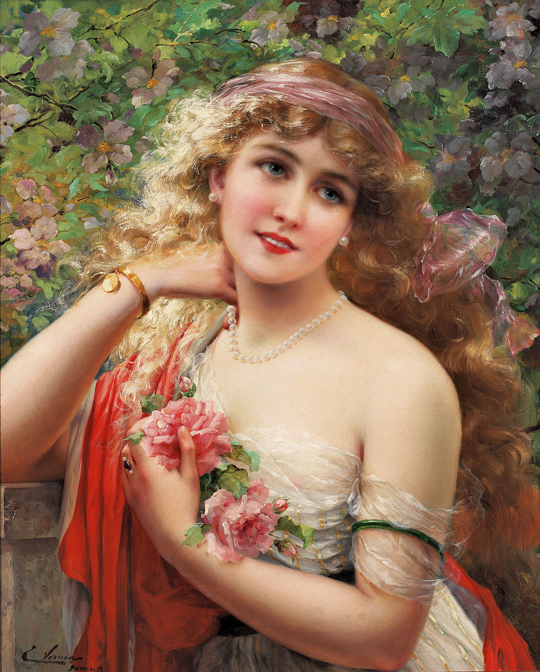

Hello!
Can someone, please, tell me what did they do to the original picture so they obtained a cleaner and clearer version?
My untrained eye saw this:
- the retouched version got rid of the shadows from chin, arms, red dress
- I think they put a lot of Sharp (everything is so much clear)
- they faded the colors (see lips, see skin tone)
How can I obtain a similar result altering the original?
Thank you!
File comment: retouched version by someone
File comment: Original from Wikipedia
1 original emile vernon -la printemps from wikipedia.jpg [ 1.29 MiB | Viewed 14708 times ]

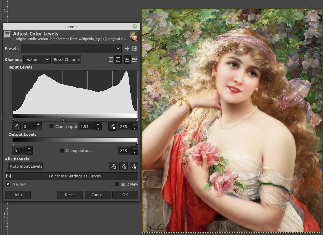

Or, you could try levels. While leaving it on 'value' take the middle slider back to approx 1.53
Another way to get rid of just a shadow is to 'select' that area, feather it then copy and paste in place as a new layer - deselect and making sure you have the new layer selected use curves or levels.

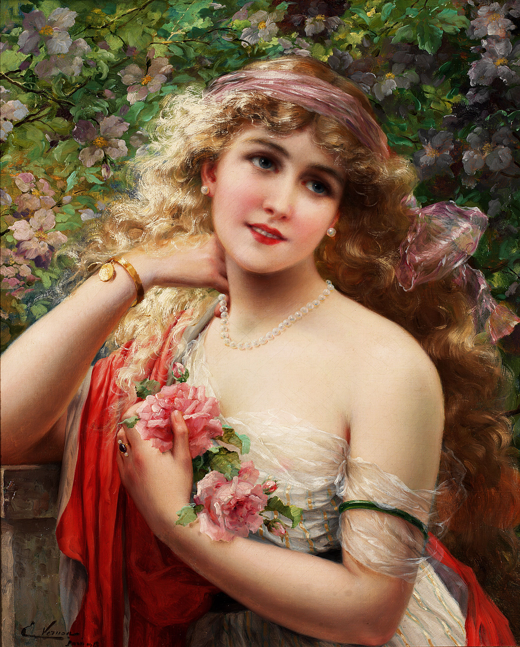

Thousand ways to Sunday to address this. I chose Retinex (selectively) and blended to taste. :)
1 original emile vernon -la printemps from wikipedia.jpg [ 1.24 MiB | Viewed 14494 times ]

sallyanne wrote:
[align=center]Or, you could try levels. While leaving it on 'value' take the middle slider back to approx 1.53
No, that, sallyanne, that was something! Thank you!
I tried what you suggested and the things look very good.
I wonder why my 1.53 sliding does not look exactly like yours.
Could you, please, have a look at my settings and tell me if everything's OK?
Thank you!
I could not get close to your result at all, no matter what I did with those sliders.
Could you, please, lylejk show me what settings did you do?
See my settings attached.

File comment: Gimp - Color - Levels 1.53
 Post subject: Re: How can I alter the original to obtain a similar result to this?
PostPosted: Sat Apr 10, 2021 5:52 am  (#8)
Posts: 8498
I am pretty sure I only moved the middle slider and nothing else. Your settings seem right. - Maybe you need to just use 1.53 as an approximation.
