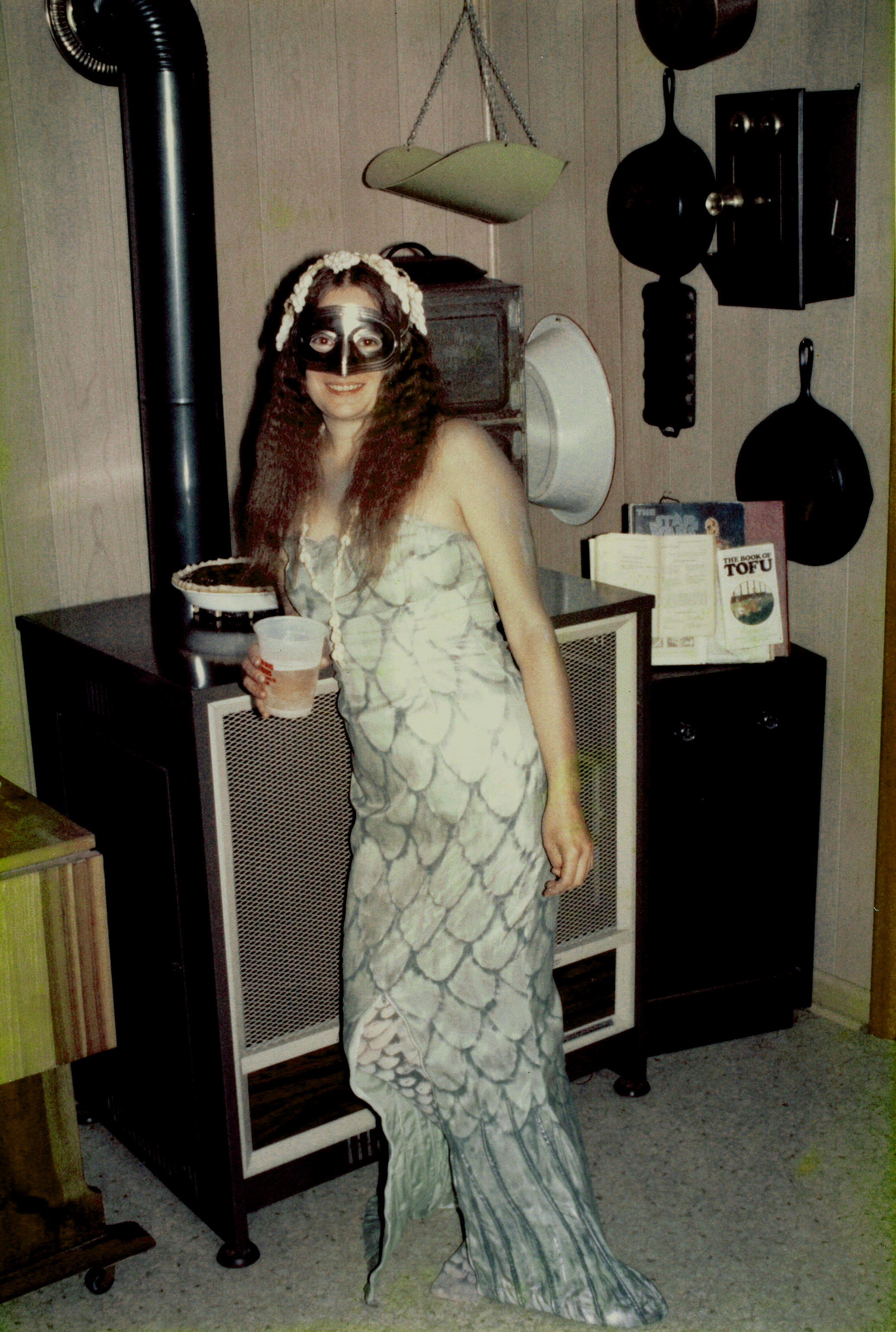

We held an annual Halloween party for 38 consecutive years. Lately I've been restoring the older photos.
I have the color balance in pretty good shape now, but the some of the photos appear to have suffered some kind of oxidation in the dyes. The result is that the edges are looking pretty greenish, and some also display greenish blotches (see provided example).
What I'd like to do is somehow gradually REMOVE the G component along the edges of this photo with the airbrush tool. Or more generally, "paint out" any color in this manner, once I figure out the exact color that will achieve my objective. After a little messing around with the Level settings it seems to be pretty close to straight green, though.
Asking the experts here on how I can go about doing that.
Thanks in advance,
Bruce

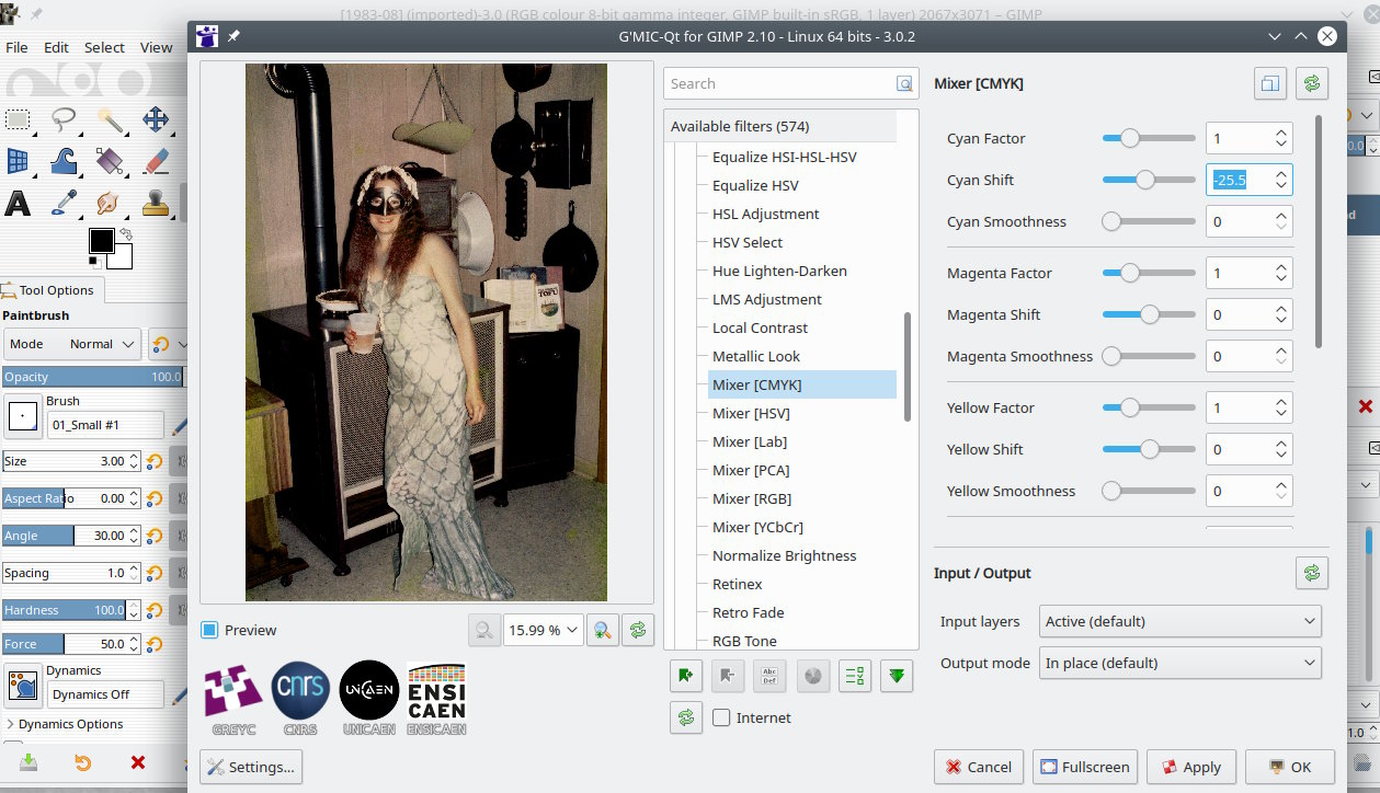

Edit: Apologies, not answering the question about green edges. More of a general approach ;)
Try the gmic plugin http://www.gmic.eu
Either the color curves or as this one of the mixer filters.

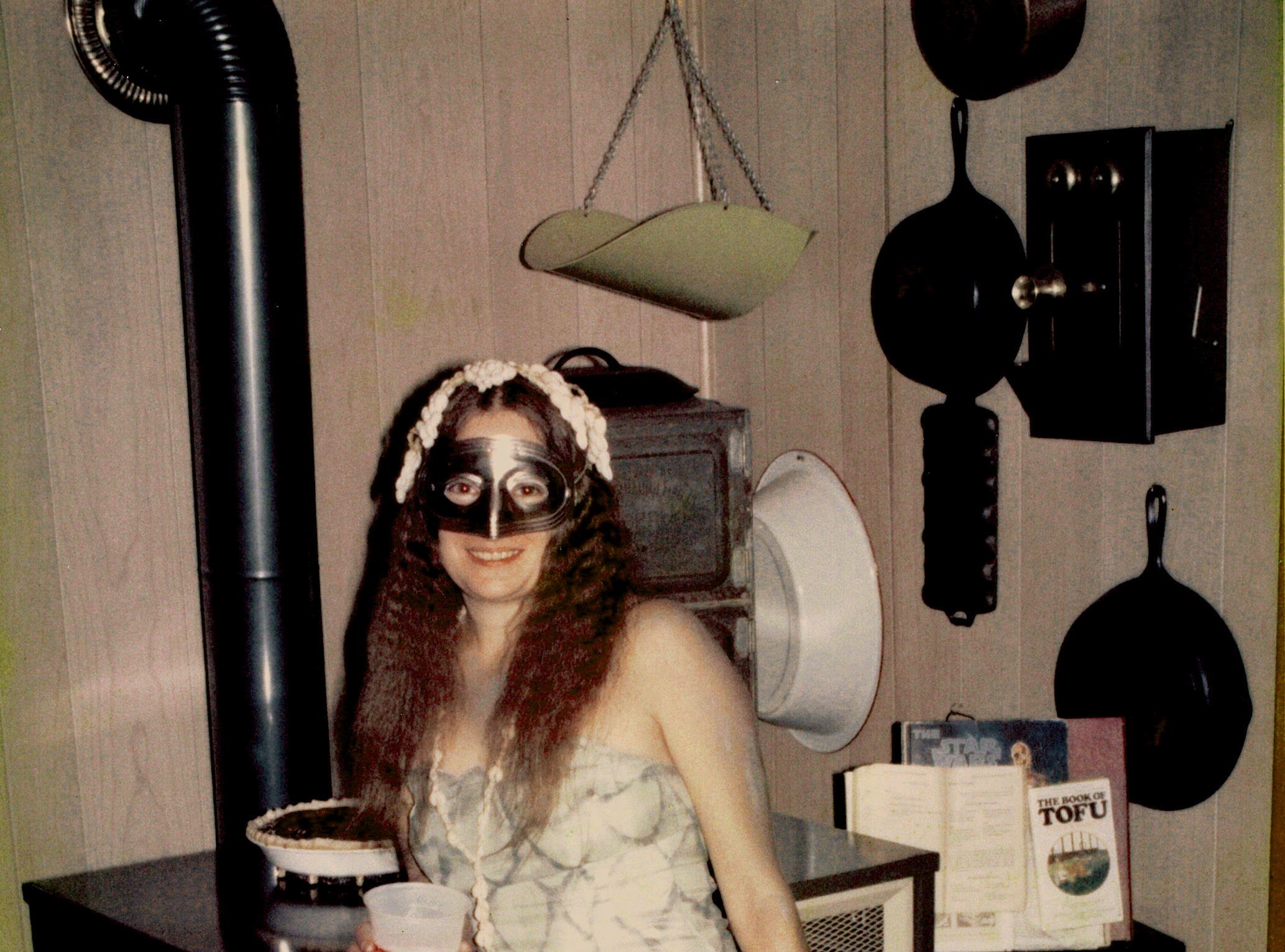

 Post subject: Re: How to "paint out" the green?
PostPosted: Fri Jan 21, 2022 7:39 am  (#4)
Joined: Dec 19, 2018
Posts: 164
Just out of curiosity I tried it out.
Basically it was used in the first image (Top) Adjustment in the color casting followed by the use of the Mixer Channel.
In the second image (Below) the opposite was done - Color Mixer with subsequent adjustment in the color casting.
https://imgur.com/a/RxGxCCn
But I don't consider any of these as ideal procedures as I got them by luck in a trial of hit and miss.

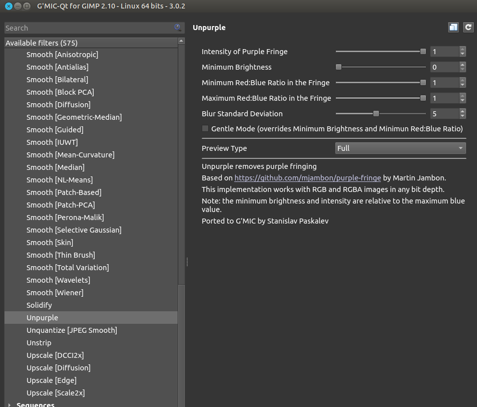

sallyanne wrote:
Did it in a couple steps!
In GMIC I unpurpled it (magenta is opposite of green)
Which function in G'MIC, do you have a screenshot?
I'm asking because at Repair/Unpurple , I don't have any magenta or green slider...
Patrice
Sally, great find! I didn't know this filter existed. So far it seems to be the best solution found, thanks for sharing! :bigthup
PixLab, just use the default values on the previously inverted image, and the effect will act on the purple areas. Then invert the image again. (basically the procedure said by Sallyanne)
The filter is the same as your image (Repair - Unpurple)

Krikor wrote:
Thanks Krikor, indeed with the default value it works :bigthup
Nice trick Sallyanne :clap
Patrice

PostPosted: Sat Mar 12, 2022 10:37 pm  (#11)
Posts: 8498
Correct Krikor, I just used the default because magenta is similar to purple in that it is reddish.
