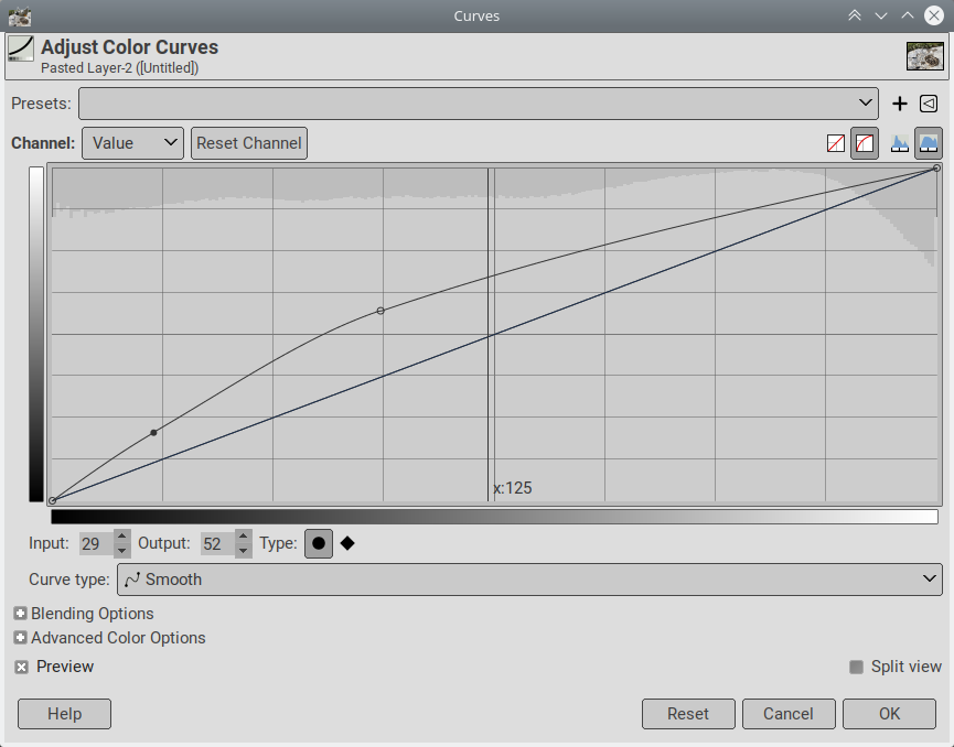

Comparing both images, a major point of your friend's picture is that the brown streak on the back is somewhat lighter so I just tried to lighten the darker part with Curves:
