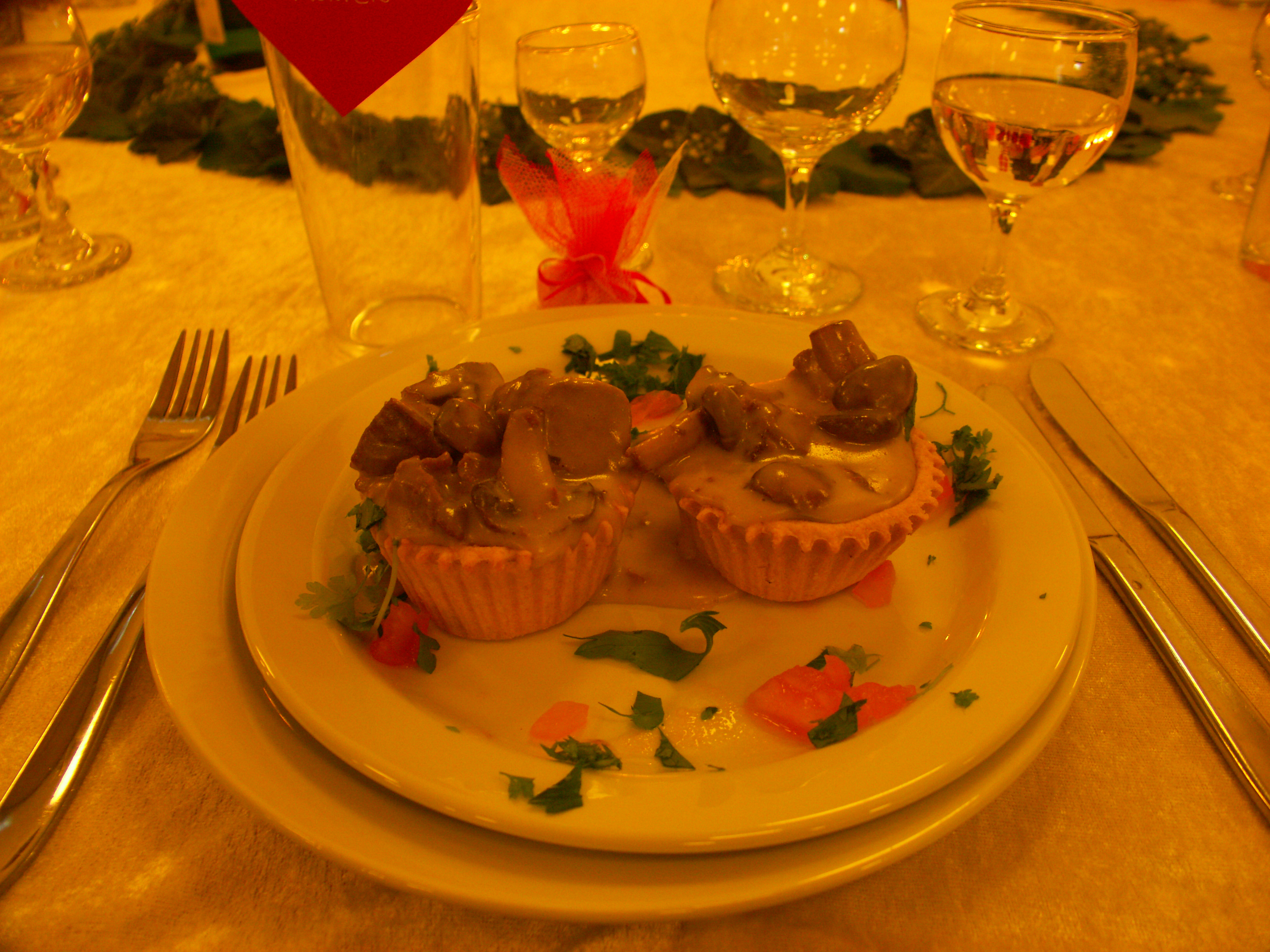

we had a frind to take pic at our wedding, he did not want to desterb the paty with flashes so he fiddelt arouns with shutterspit and ISO, but not the with balance. so we got 200 pic in verrius yellow candellight collors.
if i can doo any thing to make them more "right" in collor, what can i doo?

can i mail it to U instet of posting it ....
got one that i can post just a sec
 Post subject: Re: yellow pictures
PostPosted: Mon Oct 10, 2011 7:24 am  (#4)
Joined: Oct 10, 2011
Posts: 10
her is on with out persens on
PostPosted: Mon Oct 10, 2011 7:47 am  (#5)
Posts: 12854
Next time you need to set your camera to compensate for tungstan lighting and use some form of flash. Anyway, dup, desat top layer (I like using Luminosity Desat for this), set that desat layer to 50% opacity and flatten. Now do an auto-level. I did do a few additional enhancments. Very noisey so I did the retoucher's trick (reduced the size to hide the noise; lol). Noise is your enemy with this type of capture. :)
PostPosted: Mon Oct 10, 2011 8:24 am  (#6)
Joined: Apr 23, 2010
Posts: 1553
Well, there's hardly any blue color whatsoever so I'm not sure how much of that can be recovered. If you have the original RAW files then you might be able to boost the blue using a plug-in such as UFraw. However, if all you have is the 8-bit JPEG files then about all I can suggest is the following:
  1. Duplicate your layer.
  2. Right-click on the duplicate layer, and select the "Add Layer Mask" command. In the dialog that appears, choose the "Grayscale copy of the layer" option near the bottom of the list of radio buttons..
  3. After the layermask is created, perform "Colors->Auto->Equalize" on it.
  4. Click on the thumbnail preview of the duplicate layer and perform "Colors->Auto->Equalize" on the layer.
The result will by no means be perfect, but it will at least make bright objects white and in my experience, this approach does a pretty decent job of handling skin tones.

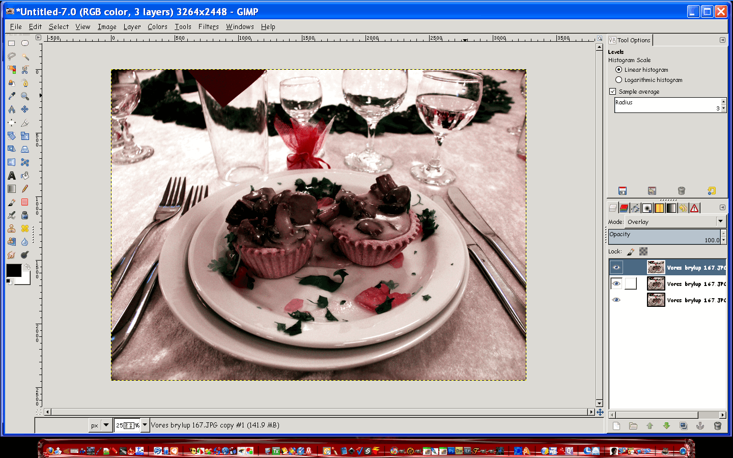

Lyle did you use DD's Luminosity filter? :)
Excellent results i might add! :bigthup

I did it the same exact way as Lyle did, except after auto levels i brought the dark parts of the image in to 20 and it brought out the colors more.
Then duplicating the end result twice ,and setting the middle layer to lighten only and the top layer to overlay works nicely afterwords. :)
Though the table clothe does look a bit blown out in some lighter areas.

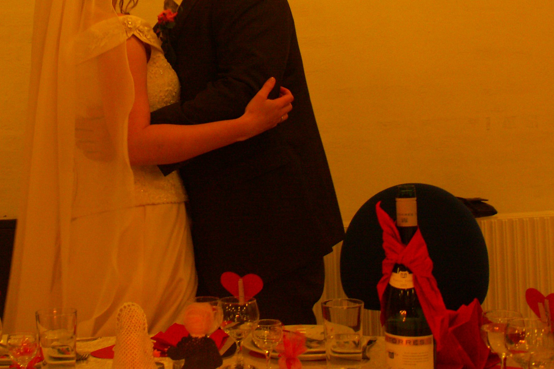

U asked for somthing with blue in it ... the chair on pic with blitzz frome the same camera ats the other with out blizz
René
