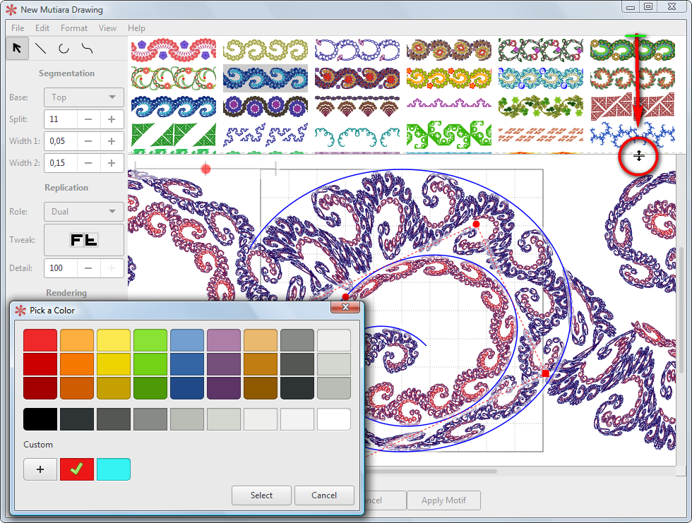

Only thing that I've notice so far is that the motifs are not showing; only have the default available. Not sure how to get additional motifs.
You have to drag the edge with your mouse.
There is another issue - not works Help Contents (files * .page do not know how to open in Windows - so not included in the package zip).

PostPosted: Tue Jun 09, 2015 2:50 pm  (#20)
Posts: 12863
:oops:
Just noted your red circled pulldown. lol
Again, thanks MareroQ; programs cool. Still need to experiment. :)
