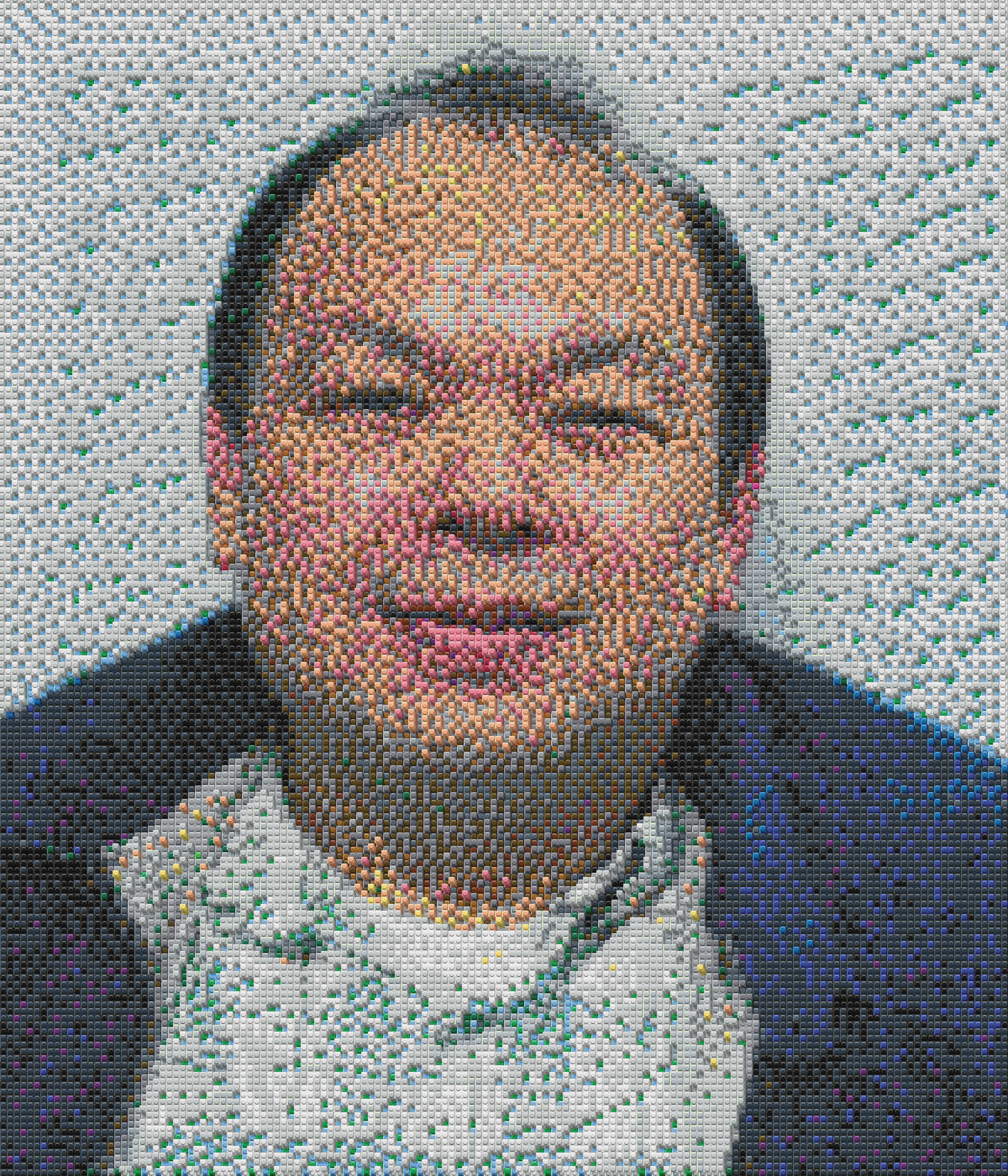

I just wish Pic2brick would allow you to re-open the file for additional tweaks. They've not updated the program in a long time now either. Maybe I asketh for too mucheth. lol
 Post subject: Re: Online Ministeck.
PostPosted: Fri Jan 09, 2015 3:21 pm  (#25)
Posts: 12850

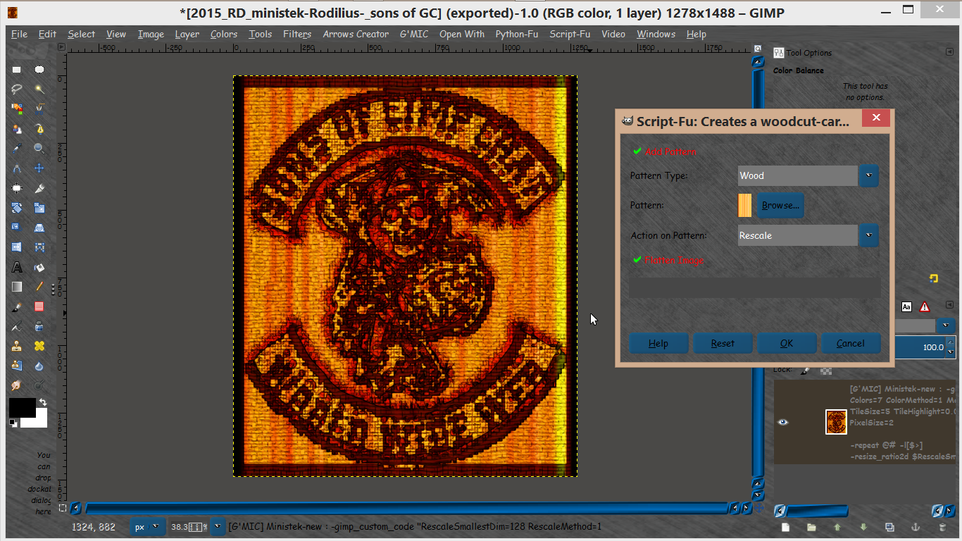

OK; had a brain fart and figured out a way to get the selections (still convoluted, but doable). Now I can do a better job at creating 3D Legos but now the lego pieces won't a have the seams that the original tute (don't ask me the link; way too lazy to find it) had (i.e., you can have distinct pieces like right angles, multiple lenth straights, vertical and horizontal, etc.). :)

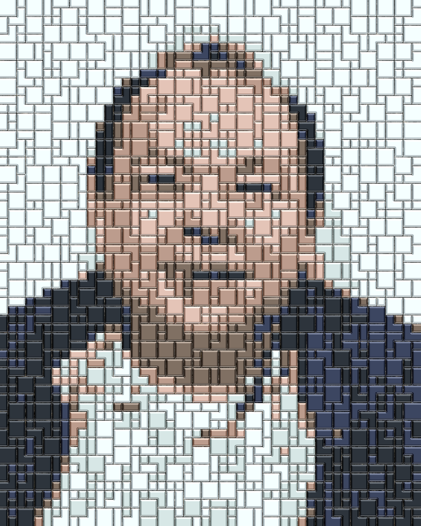

Clouds wrote:
just wish this plugin could be implemented in G'MIC easily or even a Script-fu.
I'd never heard of a "ministeck" before, but this looked like an interesting puzzle. Here's a G'MIC custom script that will sort-of replicate the concept:
RescaleSmallestDim=128 RescaleMethod=1
Colors=7 ColorMethod=1 MapContrast=1.0 Dither=0.0
TileSize=5 TileHighlight=0.10 TileShadow=0.15
PixelSize=2
-repeat @# -l[$>]
-resize_ratio2d $RescaleSmallestDim,$RescaleSmallestDim,1,$RescaleMethod
--colormap $Colors,$ColorMethod AA={ia} --[-1] $AA -*[-1] $MapContrast -+[-1] $AA
-index[0] [-1],$Dither,1 -c 5,250 -rm[-1]
--l --[0] {im-1} MM={iM} -s c -repeat @# -+[$>] $> -*[$>] {($MM+1)^$>} -done -+
--label_fg[0] 0 --area_fg[0] 0 -repeat 3 --neq[2] {$>+1} -*[0] [-1] -oneminus[-1] -*[-1] [1] -done
--r[0] 50%,50%,@{0,d},@{0,s},1 -r[-1] [0],1 -replace[-1] 0,-1 -neq[-1] [0] --oneminus[-1] -*[-1] [1] -*[-2] [1] -rm[0,1,2]
50%,50%,1,1,'x+y*w' -r[-1] [0],1
-mv[-1] 0
-r {$TileSize*100}%,{$TileSize*100}%,1,1,1
-repeat @# -l[$>]
(1,0,1;0,0,0;1,0,1) -normalize_sum[1] --convolve[0] [1] -rm[1] -- -eq 0
-endl -done
-min -dilate 2
(1,0;0,-1) -convolve[-2] [-1] -rm[-1] -+[-1] 1 -c[-1] {1+$TileHighlight},{1-$TileShadow}
-endl -rv -r[-1] {w*$TileSize},{h*$TileSize} -shift[-1] -1,-1 -*[-1] [0] --[0] 1 -*[0] 128 -+[-1] [0] -rm[0] -r {w-1},{h-1},100%,100%,0 -r {$PixelSize*100}%,{$PixelSize*100}%,100%,100%,1
-endl -done
All the parameters are in variables at the top. It'd be easy enough to make it an entry in the GIMP plugin.
Unfortunately I don't really know the "rules" of designing a ministeck. For example, a lot of the solid color areas could easily have been filled with 2x2 squares, but were not by the programs mentioned already in this thread. Why not? Well, a grid of 2x2 squares looks boring, so that's probably enough reason. :P But, then what is the rule for deciding what to do instead? For example, maybe you're supposed to use equal counts of each shape piece? I don't know, and my script merely renders the conceptually simple, boring 2x2 squares.
Attached is the result on your forum icon, Lyle, except with "MapContrast" set to 0.9 (for dimmer white/black tiles).

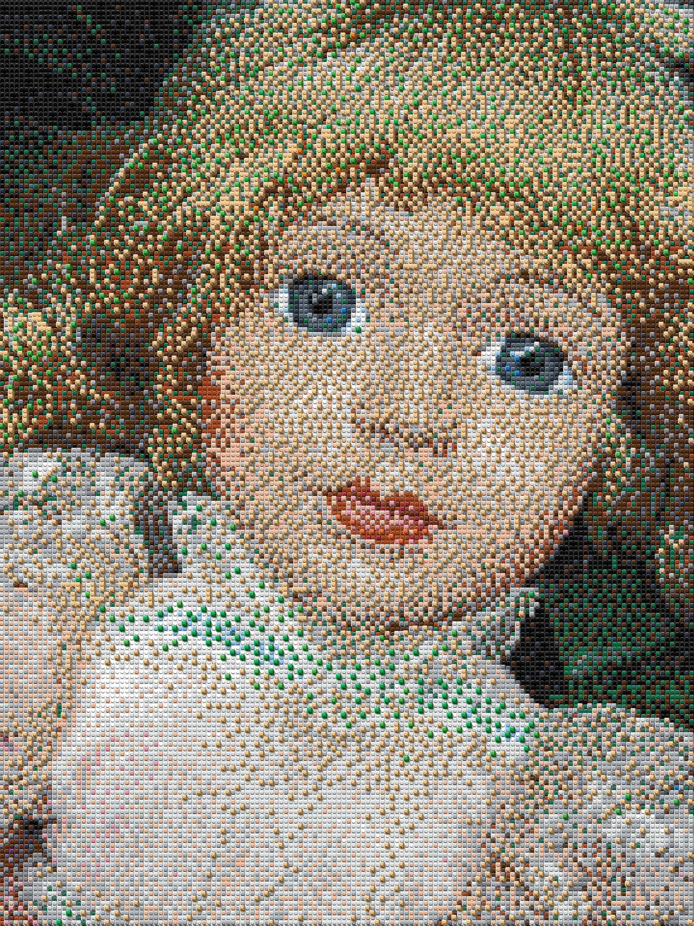

Yup; now on a Legos binge again. lolol
ref: http://www.fontplay.com/freephotos/seve ... 107-08.jpg

I just copy/pasted into G'MIC's Global input and created a preset Rod. That, at least, worked for me. Kept it all in the GIMP too; easy/peasy. :)

By the way, as it turns out, I had set up a lot of steps in my original (more boring) script in preparation for adding randomness...but never actually did when I posted it. So, there was a lot of 100% useless calculation going on. Oops! :oops: I've edited my original post with a cleaned-up version, that also works on images with alpha channels too. It's also in the following spoiler.
TileSize=5 TileHighlight=0.08 TileShadow=0.12
PixelSize=2
-repeat @# -l[$>]
-split_opacity --colormap[0] $Colors,$ColorMethod AA={ia} --[-1] $AA -*[-1] $MapContrast -+[-1] $AA
-index[0] [-1],$Dither,1 -c[0] 5,250 -rm[-1] -a c
--l -s c
-r {$TileSize*w},{$TileSize*h},1,1,1
-repeat @# -l[$>] (1,0,1;0,0,0;1,0,1) -normalize_sum[1] --convolve[0] [1] -rm[1] -- -eq 0 -endl -done -min -dilate 2
-endl
-split_opacity[-1] -*[1] [0] --[0] 1 -*[0] 128 -+[1] [0] -rm[0] -a c
-r {w-1},{h-1},100%,100%,0 -r {$PixelSize*w},{$PixelSize*h},100%,100%,1
-c 0,255
-endl -done
File comment: The G'MIC mascot Gmicky, filtered in ministeck style with my improved script.

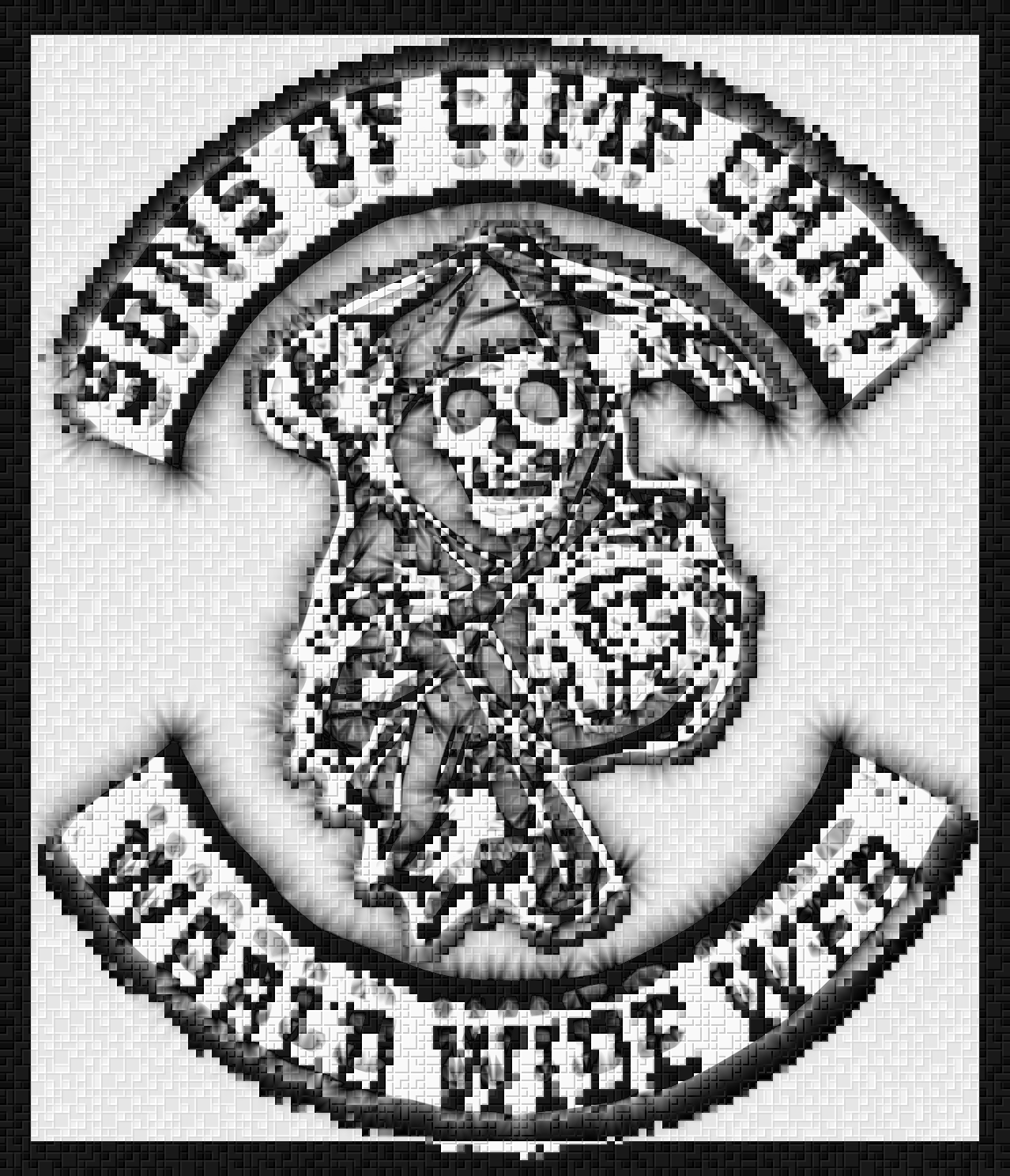

OK; toyed with your preset some so that I could get the outlines only to isolate the tiles (oh; made the tiles bigger too; lol), and then blended some textures and such to get this bathroom tiled result. So many possibilities for your G'MIC preset Cloud. Your code is extremely small too. Thanks a heap again. :)

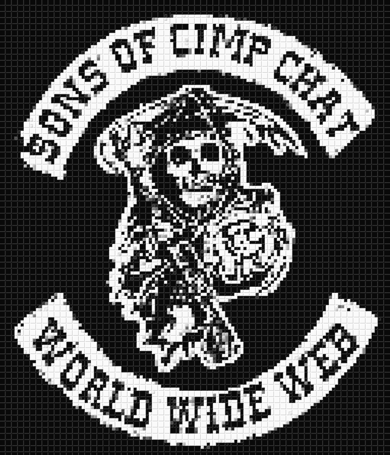

Just some more tweaks; you made me a monster Clouds. lol
Set the white grout to zero, and then use erode followed by dialate to get just black lines. I then used that as a mask and ran Graechan's Plastic or Glass for the tiles (overlay). Added stoney grout. :)
PostPosted: Sat Jan 10, 2015 8:50 pm  (#40)
Posts: 16197

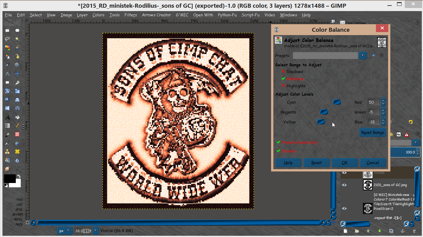

Trying to get a good woodcarving effect with color balance after. Not bad.
With the script. :)
