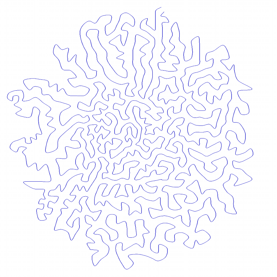

Hey Mahvin. Concorde can export a tour file. I copied the TPS file and the Tour files into Excel and created xy cells where the x and y comes from the TPS file and the index comes from the Tour file. Now I can graph too without the stupid dots. lol
Of course I chose the smooth curve chart option. Anyway, I'm sure the Open Office spreedsheet program can do this too, so now you can use the Windows Concorde program and a spreedsheet to get the vector output that you want. Notice the open ends (entry and exit of curve) that I did not close up. :)

Lyle, do you mind sharing your Excel file. For some reason, indexing in OO Calc isn't working like it does in Excel. The (x, y) graph works, superbly, but the indexing results in an odd, inconsistent shape. I want to see how your Excel file will behave in OO Calc. If you don't mind.

By the way, I was able to (not the version that I showed earlier; used Irfanview as the serrogate then) paste the plot directly into Inkscape, ungroup, delete the background stuff and then save. Very cool indeed. Excel smoothing scatter plot option is definitely the bomb. Just did this baby doing just this (third version down; had to scale down since the original had the equivalent of 4000px wide; lol). :)

Oh wow, that turned out really good. Can you give a step by step that process in a quick list? I don't have Ifranview, but was wondering how that would work out in XnView. I'll grab Irfanview if it comes right down to it.

Irfanview can automatically turn vector content to bitmap with copy/paste. I just copy the graph, paste it into Irfanview, then copy it from Irfanview and Paste it into GIMP and do the cleanup in GIMP. I still prefer the vector route (using Inkscape). Copy and paste into Inkscape, set the pagesize to equal the image (Image size will be much bigger; trust me), ungroup and removed the junk (I do most of this in Excel but still the background and border has to be removed) and then save the SVG file and open it up in GIMP. Either way will work though. I'm now almost a Geek. lol
