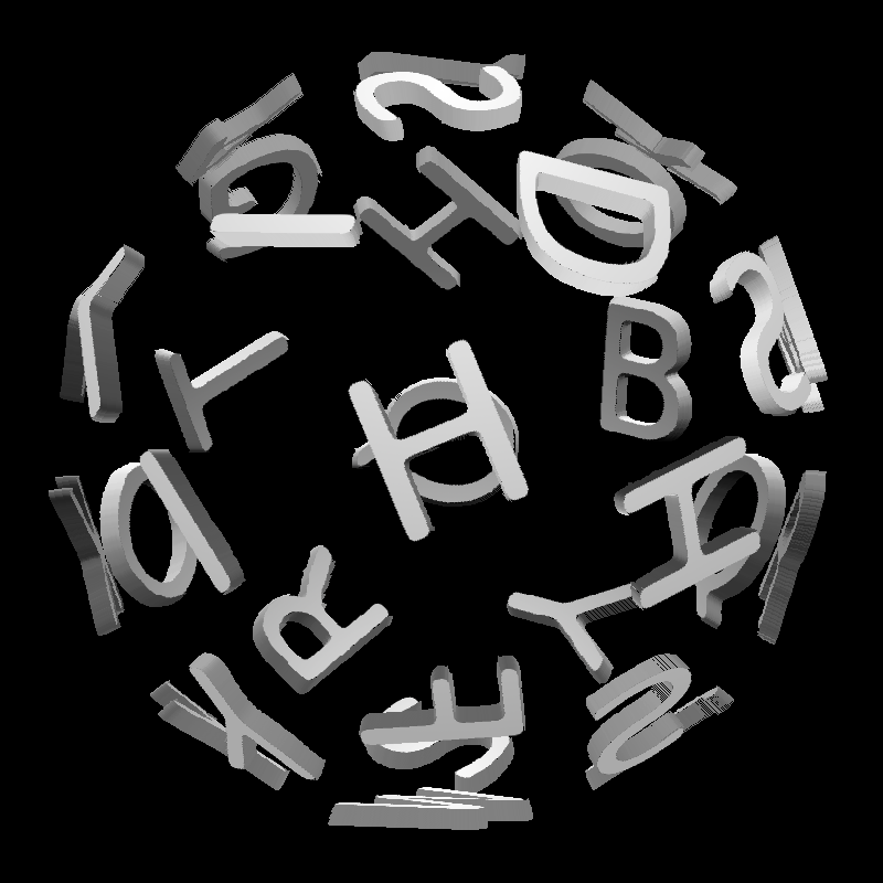

K1TesseraEna wrote:
[font=Tahoma]Obviously I don't have enough skills to make such an image with gimp
(and wouldn't even dare to try) but I can do it fairly quickly with Blender ;)
Yup...it's pretty clear a 3D program is "the right tool for the job" here.
Still, there's a certain allure to the puzzle of trying to achieve it with some other, less well-suited tool. ;) I've been noodling over it for a while for fun, on my own. So far I've gotten as far as the attached image generated using Gimp and G'MIC.
