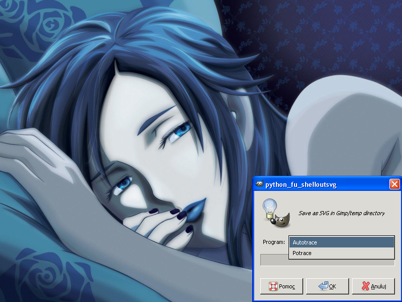

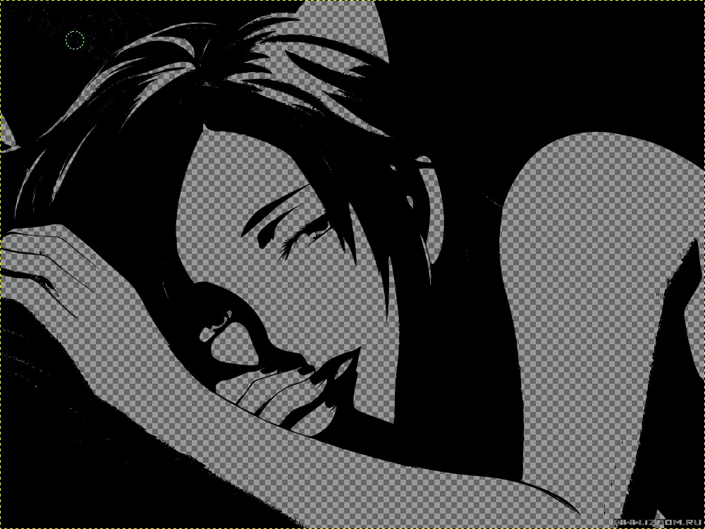

PostPosted: Tue Apr 05, 2011 12:58 pm  (#16)
Here's a batch file that I created to use with Potrace; just copy it in your Potrace directory (save it as pt.bat if you like). Your bitmap has to be a BMP file (not PNG, or anything else; well, it could be a pgm, pbm, or ppm too). Just copy a shortcut to your desktop and then drag a bitmap file on top of it and release. You will get an SVG result to use whereever you want to use it in. :)
potrace -r 72 -t .2 -x 1 -a 0.85 -s %1
Using XNViewShell can and png ...
TRACE_LYLE.ZIP [2.56 KiB]
Downloaded 223 times
 Post subject: Re: Using Potrace
PostPosted: Tue Apr 05, 2011 1:17 pm  (#17)
Trace_Lyle.py
#!/usr/bin/env python
# -*- coding: utf-8 -*-
call an external program passing the active layer as a temp file.  Windows Only
Author:
Rob Antonishen
Version:
0.4 modified to support many optional programs.
this script is modelled after the mm extern LabCurves trace plugin
by Michael Munzert http://www.mm-log.com/lab-curves-gimp
and thanks to the folds at gimp-chat has grown a bit ;)
License:
This program is free software; you can redistribute it and/or modify
it under the terms of the GNU General Public License as published by
the Free Software Foundation; version 3 of the License.
This program is distributed in the hope that it will be useful,
but WITHOUT ANY WARRANTY; without even the implied warranty of
MERCHANTABILITY or FITNESS FOR A PARTICULAR PURPOSE.  See the
GNU General Public License for more details.
The GNU Public License is available at
http://www.gnu.org/copyleft/gpl.html
from gimpfu import *
import shlex
import subprocess
import os, sys
import tempfile
#program list function (globals are evil)
def listcommands(option=None):
  programlist = [
  ["Autotrace", "\"C:\\Program Files\\Autotrace\\autotrace_lyle.bat\""],  #<<<-----SET ME<<<----- (Directory where you place your bat)
  ["Potrace", "\"C:\\Program Files\\Potrace\\potrace_lyle.bat\"", "bmp"], #<<<-----SET ME<<<----- (Directory where you place your bat)
  if option == None: # no parameter return menu list, otherwise return the appropaiate array
    menulist = []
    for i in programlist:
      if i[0] != "":
        menulist.append(i[0])
    return menulist
  else:
    return programlist[option]
def plugin_main(image, drawable, command):
  pdb.gimp_image_undo_group_start(image)
  temp = pdb.gimp_image_get_active_drawable(image)
  buffer = pdb.gimp_edit_named_copy(temp, "ShellTemp")
  #save selection if one exists
  hassel = pdb.gimp_selection_is_empty(image) == 0
  if hassel:
    savedsel = pdb.gimp_selection_save(image)
  tempimage = pdb.gimp_edit_named_paste_as_new(buffer)
  pdb.gimp_buffer_delete(buffer)
  if not tempimage:
    raise RuntimeError
  pdb.gimp_image_undo_disable(tempimage)
  tempdrawable = pdb.gimp_image_get_active_layer(tempimage)
  # Use temp file names from gimp, it reflects the user's choices in gimp.rc
  # change as indicated if you always want to use the same temp file name
  tempfilename = pdb.gimp_temp_name("bmp")
  #tempfilename = os.path.join(tempfile.gettempdir(), "SheTempFile.bmp")
  # !!! Note no run-mode first parameter, and user entered filename is empty string
  pdb.gimp_progress_set_text ("Saving a copy")
  pdb.file_bmp_save(tempimage, tempdrawable, tempfilename, tempfilename)
  # Command line - Change to match where you installed XnView
  progtorun = listcommands(command)
  command = progtorun[1] + " \"" + tempfilename + "\""
  args = shlex.split(command)
  # Invoke external command
  pdb.gimp_progress_set_text ("calling " + progtorun[0] + "...")
  pdb.gimp_progress_pulse()
  child = subprocess.Popen(args, shell=False)
  child.communicate()
  #load up old selection
  if hassel:
    pdb.gimp_selection_load(savedsel)
    image.remove_channel(savedsel)
  # cleanup
  os.remove(tempfilename)  # delete the temporary file
  gimp.delete(tempimage)   # delete the temporary image
  # Note the new image is dirty in Gimp and the user will be asked to save before closing.
  pdb.gimp_image_undo_group_end(image)
  gimp.displays_flush()
register(
        "python_fu_shelloutsvg",
        "Save as SVG in Gimp/tmp directory",
        "Call an Trace program",
        "Rob Antonishen",
        "Copyright 2011 Rob Antonishen",
        "2011",
        "<Image>/File/Eksport image as svg...",
        "RGB*, GRAY*",
        [ (PF_OPTION,"command",("Program:"),0,listcommands())
        plugin_main,
main()
PostPosted: Fri May 06, 2011 3:23 pm  (#18)
For holders of Linux is yet another old program (but it works in Ubuntu 11.04)
Potracegui
http://pkgs.org/debian-lenny/debian-main-i386/potracegui_1.3-2.3_i386.deb.html
http://pkgs.org/debian-lenny/debian-main-amd64/potracegui_1.3-2.3_amd64.deb.html
The Gimp (ShellOut) can only be indirect call - then copy -> paste
PostPosted: Fri May 06, 2011 8:26 pm  (#19)
Posts: 16194
I tried your python file in Gimp-2.6.11 and it didn't work for me.It looks like its doing something and it creates a svg file in local settings/temp but the file is not usable. (it will not open).
