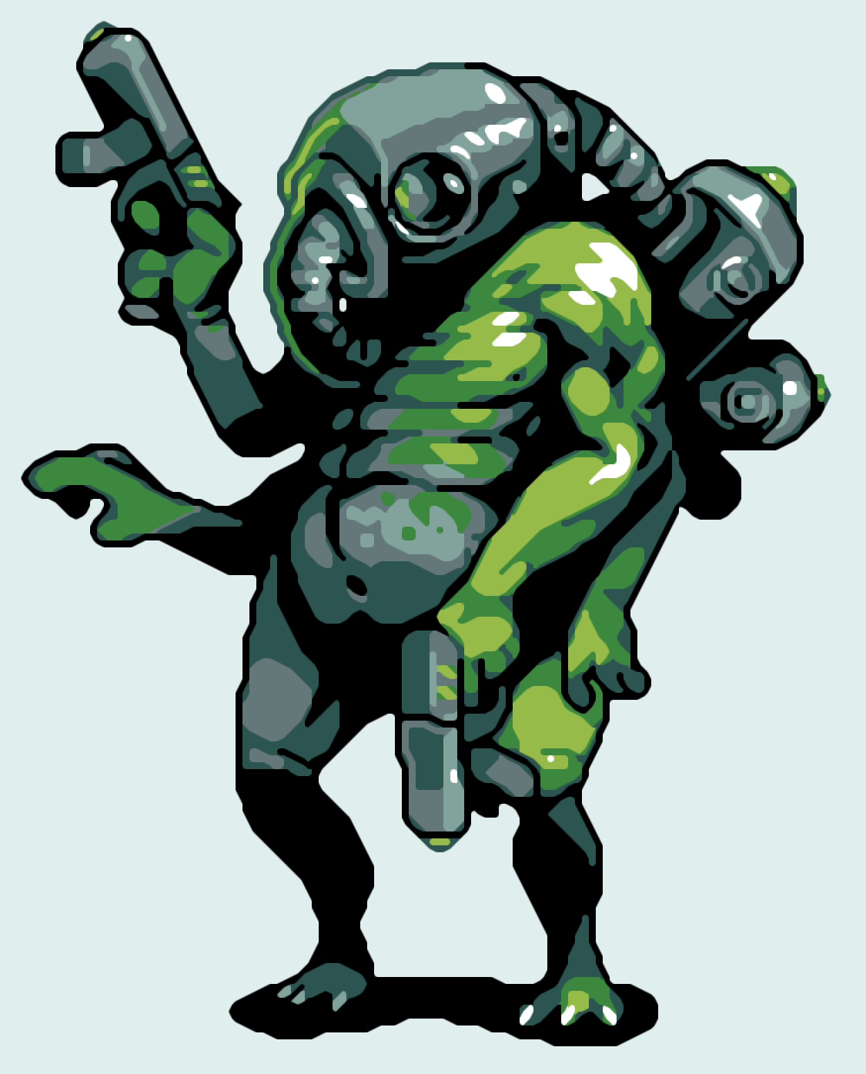

xBRZ scaling is pretty darn good. Maybe we can get David to add this ability in G'MIC. :)
http://sourceforge.net/projects/xbrz/

Would the GMIC filter xBR2x by Garagecoder be w2hat you are looking for?
 Post subject: Re: Scaler Test.
PostPosted: Thu Feb 05, 2015 9:15 pm  (#4)
Posts: 12850
Ah; had no idea it was there. Need to add a 2x,3x,4x,5x slider that this program has and do a better job addressing the stairstep, but Garagecoder's implemention is nice. Thanks for pointing that out bilbo9955. :)

Yes; I did. Still would be cool to have the slider Graechan. Also, note the stair-stepping with the G'MIC implementation. Not sure why that is since the stand-alone program is pretty clean. :)

Again, other then the stair-stepping issue, the results pretty good with the G'MIC implementation Dinasset. :)

Thanks for posting GC; other then no multiplier argument, the only thing I see different between the stand-alone and your preset is the stairstepping. Almost straight with the stand-alone, but clearly visible with the G'MIC preset. Don't know if there's some additional processing going on with the stand-alone to straighten the angled lines. Also, with Graechan's second example, I see a clear halo; not sure that is caused by any additional processing that Graechan did. I went ahead and ran the stand-alone twice (x5 then x2) to share that the lines have little aliasing (stair-step) issues). :)
