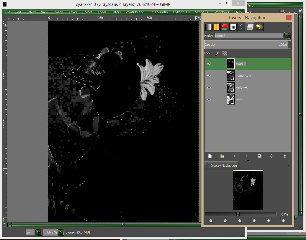

Example of what I'm referring to. You can convert your RGB photo image to CMYK channels. If you have each of the channels of your CMYK, you can Recompose to RGB in GIMP too; colors might be slightly off. :)

Thanks Lyle.
I'll try to do this.
