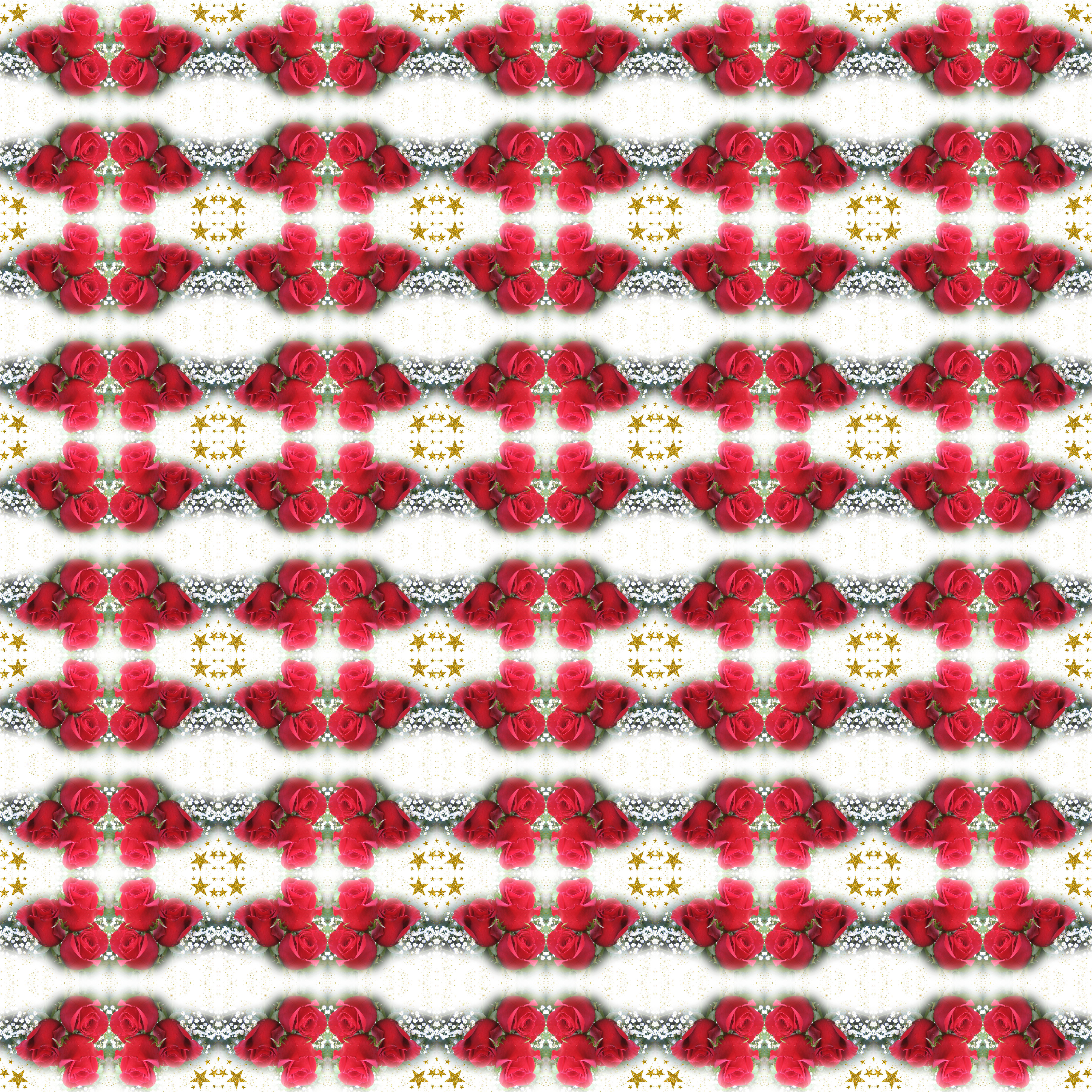

there is an easy manual way to create a seamless pattern:
1-choose any image you like but preferably render it squared
see attachment 3roses 400
2-open G'mic, go to Testing/Ronounours/Faded mirror
3-set both values to 0
4-run it once with the x axis selected
5-run it a second time with the y axis selected
you get a seamless image
6.save it as a .pat
see attachmnent 3roses pattern
to experiment create a new image and fill it with the newly created òpattern
see attachment example
3roses-400-seamless.pat [1.83 MiB]
Downloaded 183 times

Very cool dinasset. It looks easy enough, I will save this for future use... thanks for sharing.
