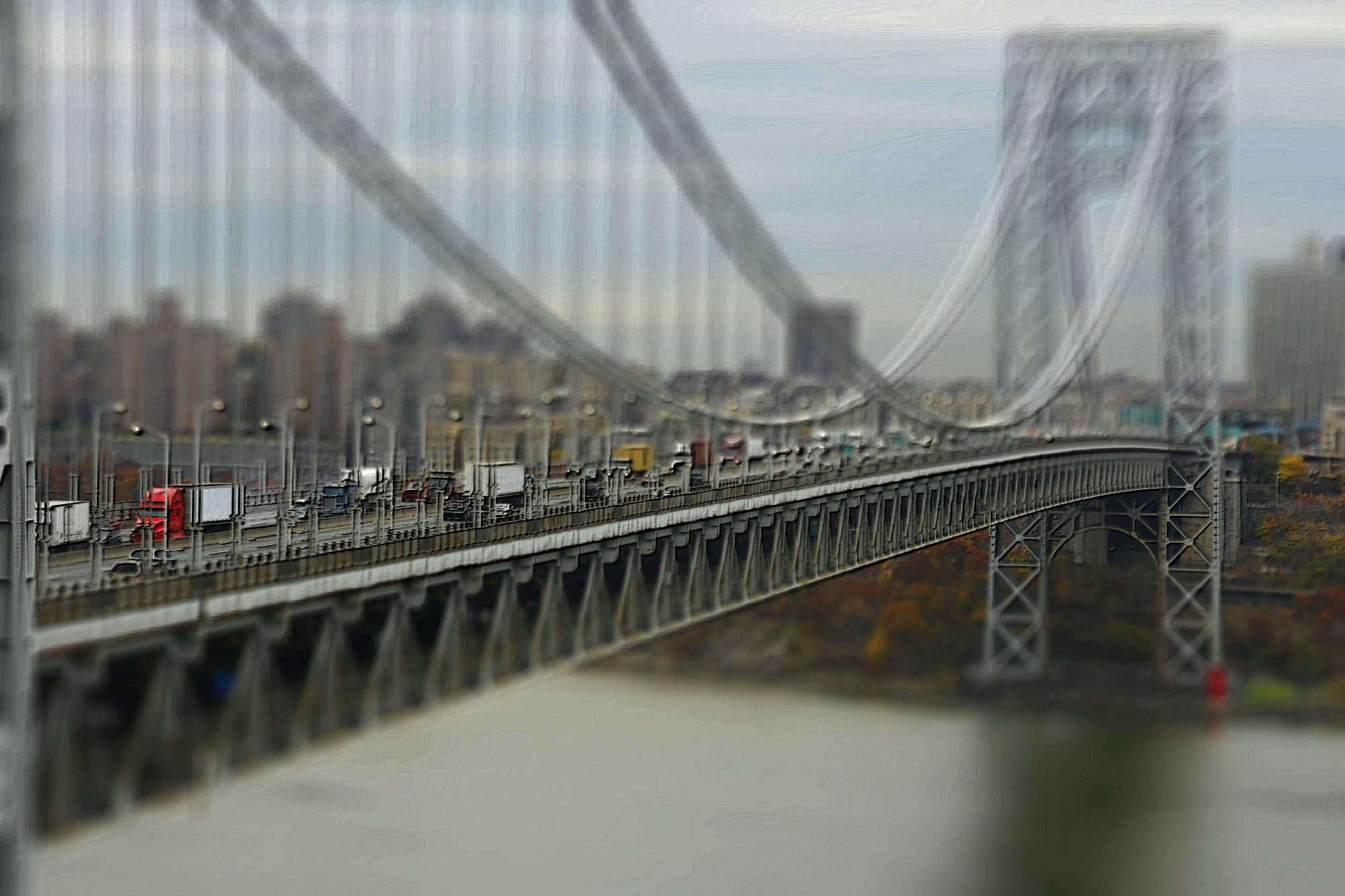

I am trying to find the name of this effect. I know i did this years ago with a Google Chrome plug-in
but i would much rather do it in GIMP than an app that i font really feel safe with.
File comment: George Washington Bridge

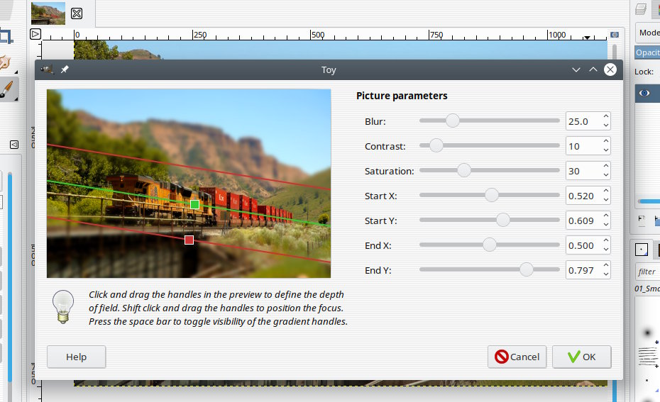

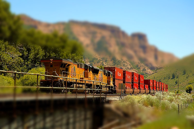

It is a blur but a specific style called tilt-shift see: https://librearts.org/2011/11/toy-plug- ... ift-fakes/
This in my linux gimp appimage:
Attached my 64 bit linux plugin and pulled from archive, samj's versions (32 / 64 bit) for Windows ( not tried those)
plugin-toy.zip [107.66 KiB]
Downloaded 275 times

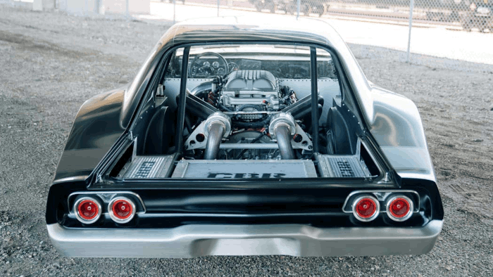

I generally prefer to do it manually using masks.

I was watching a tutorial on bump maps .. and made a mistake - but i liked it and tried it on the tilt-shifted image
[ bump map itself , basically ]
GIMP drops we down another rabbit hole .. lol
