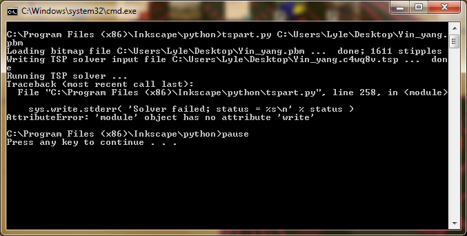

Not going to rehash all that I've done already at the registry, but the link to that is here (http://registry.gimp.org/node/22301). I did use the Stipple program mentioned a few days ago, used Inkscape to scale down the points to a dot, converted it into a pbm file (in GIMP), and then fed the results into the python program (not a GIMP plugin though). I couldn't get the non-GIMP python programs to exactly work, but, with mods, got it to at least retain the TSP file (so I was able to digitize the bitmapped points anyway) and open the resulting TSP file in Concorde and do a quick plot and then copy/paste and merged in GIMP. If any python programmers out there can help me, I won't mind. Again, I got it to the point of getting the digitized file to create (TSP), but I then get this error.

I fixed mine in Ubuntu, tell me what line 258, in tspart.py, says.
Are you placing your pbm file as input-file?

Hey Mahvin; I don't have a debugger or code editor, but believe this is the area where it is failing. I pretty much am sure it has to do with the sofile variable. I know tspfile is correct since I was able to block the deletion of the tsp file (which means the code that digitizes the bitmap is running correctly) and I'm using that file to run it in Concorde. If you got it to port the SVG file (i.e., had to solve the problem before doing so), then I'm all ears. Sucks to do it manual, but still, better then not being able to do so at all. Again, programmer I'm not. lol
# Run the solver
print 'Running TSP solver ... '
cmd = LINKERN + LINKERN_OPTS % ( linkern_runs, solfile, tspfile )
pipe = os.popen( cmd, 'w' )
status = pipe.close()
 Post subject: Re: The Traveling Salesman problem.
PostPosted: Thu Feb 10, 2011 7:27 pm  (#5)
Well, in Ubuntu, I had to re-direct tsp to my linkern binary which was in my concorde folder, it was looking for it in usr/local/bin. So, after a quick thought, I just moved the linkern binary to usr/local/bin and it ran without errors, I have a beautiful svg file that looks lovely in Inkscape, but can't see a decent way to get the paths to play nice in GIMP.

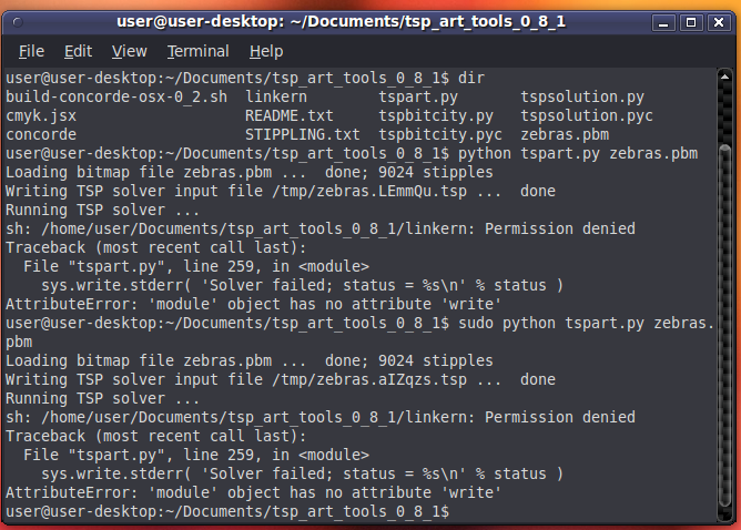

Just realize that the erro did change. Now I get permission denied. I wonder if linkern needs to be run in Wine or not? Well, too tired to go the another set of iterations right now in Ubuntu. Might try later. :)

The binary or the whole folder? And can you open gedit and turn line numbers on and see what line 259 says. I check my own and they don't say the same thing as your Windows error did.
PostPosted: Thu Feb 10, 2011 9:08 pm  (#12)
I put all my py files in the Concorde folder, cd to Concorde, copy a pbm to Concorde, and run the terminal command from there. And it works. Linkern binary is the only thing I moved to usr/local/bin.
