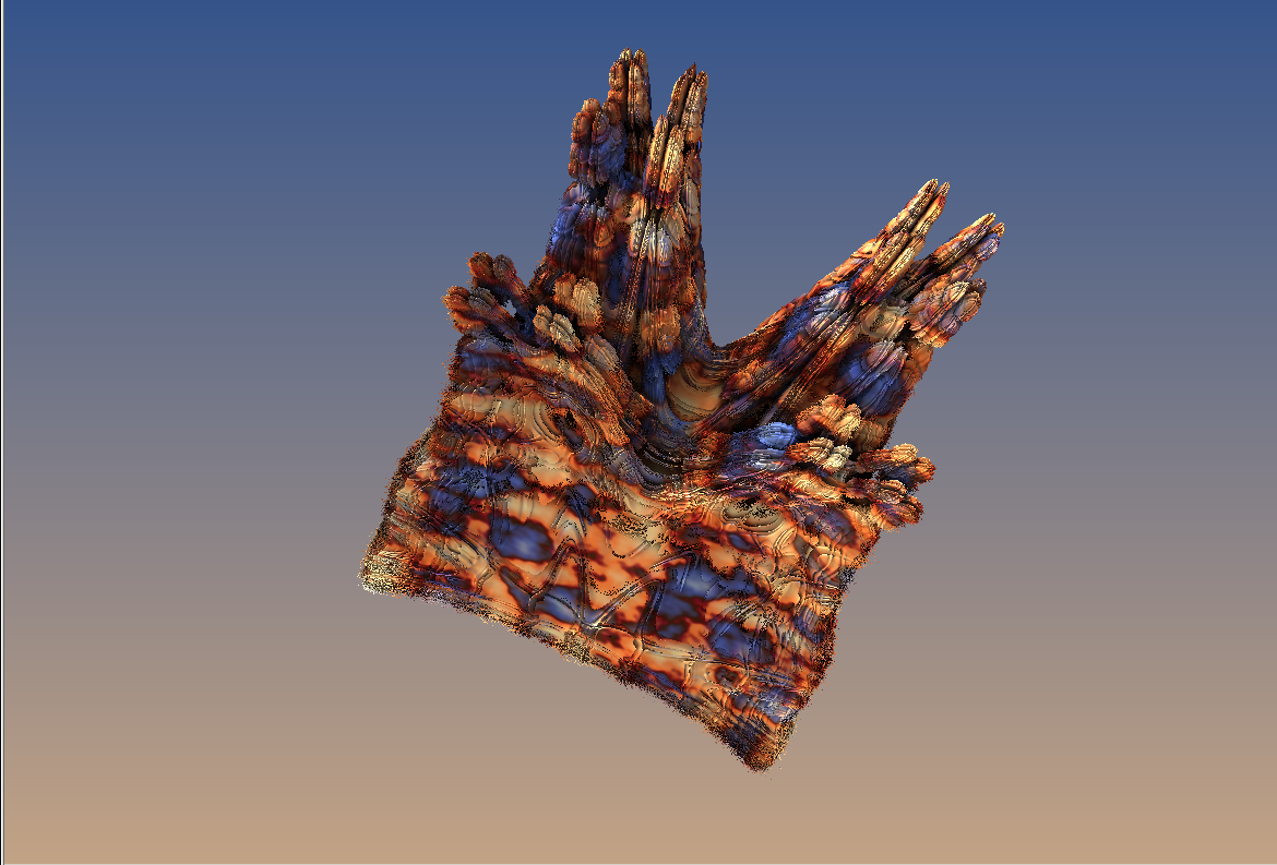

I yesterday installed version 1.8.9 which I run in "wine".
I just played around and got something I would try and save as .png.
This was the result.
I then made a screenshot with ksnapshot and this is what it actually looked like.
Needless to say I'm not very pleased with the first one.
Anyone know what I did wrong.
Gerard.
Gimp-2.8.14
I use Linux only.
And Virtualbox with Win 7
 Post subject: Re: Mandelbulb3D
PostPosted: Mon Jul 15, 2013 2:41 pm  (#2)
yes you saved the z-buffer instead then the image you were working
The z-buffer may be quite useful (as example is a perfect layer mask to remove the bg) but obviously is not what you wish
Anyway , to save ...first click on the SAVE ,NOT "Save Pic" just "save"
Then the 1 button to the RIGHT, it is written "jpeg" but may save also png, and will save with the same name also the parameters
And you may wish also save in the proprietary format , (for similar reason you may wish save in gimp as xcf) for that is , in the same tab the first button to the LEFT.

Yes and the tab "save pic" could be misleading,
you may save the png also from there (not the button you used , one at left )
BUT that will only save the png, what i suggested will save in the same folder, with same name the PNG and the parameters , parameters are few kb files but very useful, so save both is usually the best
And remember to save the M3i first (as i said "Save" tab, the last on left) because if you want reopen a image to modify , then you may do on the flight (using the parameters you will have to render again, and on same images that may take long
Remember : M3i images are loaded very quickly in M3D, the parameters need to be rendered again
PS
Luckily even if you don't save the parameters they are automatically saved in the "history " folder when you send the image from the 3D navigator to the main program
Better save parameter and png toghete , but may be useful to recover
