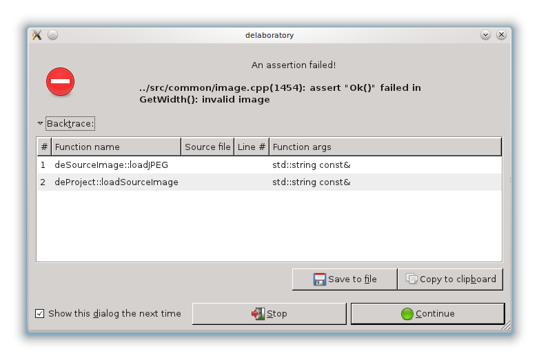

Did someone succeeded in using ShellOut ?
I have only so many mistakes.
["Delaboratory", "\"/usr/local/bin/delaboratory\"", "png"] - Error
["Delaboratory", "\"/usr/local/bin/delaboratory\"", "tiff"] - Error

Hello,
Thanks for announcing it here :)
(I wasn't aware of this forum, announced it only on flickr and gimp talk).
I never used shellout, is it a way to call delaboratory from GIMP itself?
I will try to fix the problem when I will be able to repeat your steps.
The png won't work for sure, the tiff may be problematic if it has 4 channels instead 3 (it's already fixed on SVN).

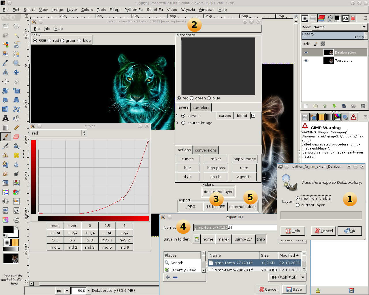

If anyone is interested this is the solution of the problem:
to call Delabolatory (0.5.9.2 beta ) in GIMP menu - adapted from an earlier version of Michael Munzert'a plugin Python (written for Photivo)
Limitation for Windows: Delabolatory not be in a directory whose name contains spaces - as default location C: \ Program Files \ Delabolatory change such as c: \ Delabolatory.
Delabolatory correct path to the program is part of the line 67 [path] - edit: opening plugin in a text editor (preferably Notepad + +).
Two versions of the plug: for Windows (Export this Delaboratory Win.zip) and Linux (Export this Delaboratory Linux.py.tar.bz2) in annex.

 Post subject: Re: Delaboratory
PostPosted: Sun Feb 05, 2012 3:40 am  (#17)
Posts: 16197
Yes this is much better.Nice results too. :)
I like the export to Gimp-2.7 option.
Here are my two examples.
Inside Delaboratory
Result after Gimp-2.7 fixes
I like it quite a bit.
