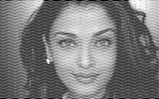

Ran across this cool program for creating vector traces of bitmaps. Makes for some cool guilloche results. :)
http://libregraphicsworld.org/blog/entry/zebratrace-0-5

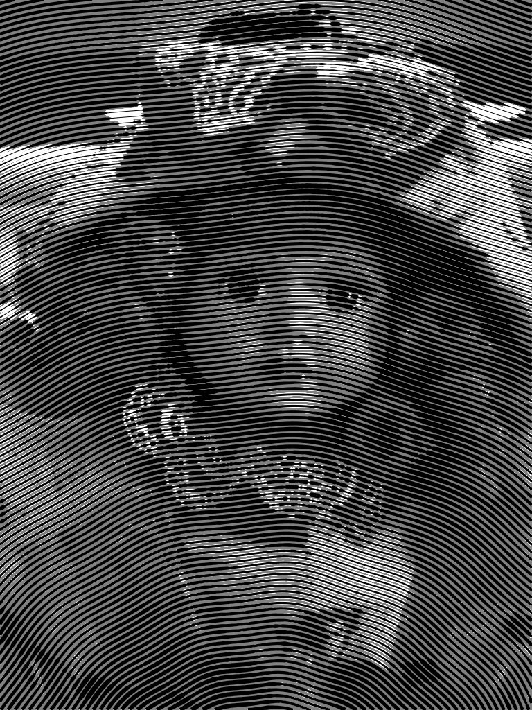

ref: http://www.fontplay.com/freephotos/seve ... 107-03.jpg
Glad this cool utility is making a comeback so to speak. Decided to blend a few layers of different ZT outputs for this result. Might edit my shellout to work with ZT Rod but too lazy right now. lol

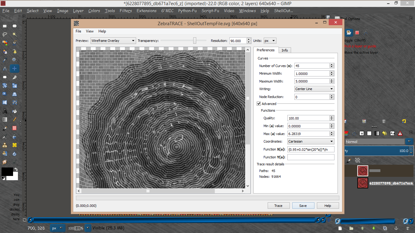

@Rod
thanks!
I added the line you kindly provided, thus I see the new program in ShellOut, but when I click gimp says "unknown file type".
What should I add into Gimp? is there a "save as svg" piece to be added?
edit: I have SVG Export installed and showing under Utils...
edit2: maybe the base image from which ShellOut is called must be itself an svg file?
in this case it's useless...
edit3: I should remove the hypothesis I made on edit2: the same image directly opened in Zebra (i.,e. not going thru Gimp>Shellout) is processed appropriately
thus there must be something missing in my gimp

@Rod
thanks!
Did you install the newest shellout.py version? This must be in the code for the command line to run and to get the correct file type.
  #get the program to run and filetype.
  progtorun = listcommands(command)
This was something Rob A added for Lyle and i to run different image extension other than PNG. At least i think that is the added code line. :lol GIMP-2.8.10 or newer GIMP-2.8.14 both should run SVG out of the box. As i stated before the temp is saved as a SVG and imported back into GIMP but it is NOT a svg or PATH layer. It's just a regular RGB layer. :) The temp svg file is then discarded.
By the way any image should work. svg at the end of the line code tells the Zebra Trace program (lies to it ) that it is a temp.svg file and can be re saved as such.

Rod, that line is in my version of Shellout
on the top it says it's version 0.7
is it ok?
 Post subject: Re: ZebraTrace
PostPosted: Tue Nov 18, 2014 8:01 am  (#16)
(addendum)
to make a re-test:
- redownloaded shellout.py from the registry and moved into the folder
- edited adding the line you suggested
- cleared gimprc and pluginrc
- restarted gimp
- checked the newly downloaded shellout was called (in the previous I had a different list of programs to call): OK
- selected ZEBRA
- .... same error
I put here the image of my desktop at error time
it seems the error comes from pdb.gimp_file_save
hence I come back to my original question
is there something I have to add to Gimp file management?

Try and change svg in that line of code to png and see what happens.I am not certain of the reason it errors. Perhaps Rob A can shed some light. Try and PM him. It worked for me after changing the extension to svg.

Rod, these are my last news:
a) to continue testing without any kind of impact on my installed gimp (if any) I downloaded and installed the last version of Gimp Portable (2.8.14)
b) copied inside the plug-in folder of that one the "shellout.py"
c) tried again w/o any change: same result as in standard Gimp
d) changed "svg" into "png": ZebraTrace starts (very good!)
e) choosen my options in Zebra then clicken on "save" (ZT wanted a name: given)
f) exited ZT
g) the return to Gimp didn't show the "traced" layer
h) thus opened the temp file (whose name I took a note)
i) ok, it's the traced file (as if created by ZT standalone)
j) hence, my more specific question ( if you have the patience to read me again)
1-you wrote This is the file that will be created and exported back to GIMP as a new layer.The temp SVG file will be deleted.
did you mean that the interface performed that or the user (me) should do what I did: go to the temp archive and open myself the traced layer?
in the first case, the interface I have does not perform its task
2-could you attach here zipped the shellout you are using to do a comparison with the one I have?
thanks a lot again
edit: I PM'ed to RobA asking whether he wants to read this topic

This is exactly why i renamed png to svg.
When GIMP (Shellout) opens the ZebraTrace program Zebra wants to re save after you do your editing to a svg file. IF the temp file is already a svg (which Shellout saves it as if it is svg and not png) then ZebraTrace will send it back as a new top layer then Shellout deletes the svg temp file.You should not have to name the file when you save in ZebraTrace. It should save and send back to GIMP automagically. :)
This is how it SHOULD work if you have added the line of code i provided. This is why i suggested to contact Rob A. because something isn't right. You need to figure out how to save the temp file to a svg extension. Can you paste your shellout.py code for me here please?
