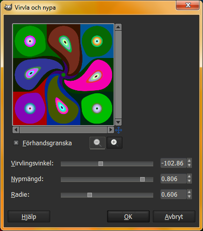

step 4: go to filters - distort - whirl and pinch. i use these settings (my gimp copy speaks swedish, but i think you can manage):
sometimes you have to pull the pinching amount up or down a little to get the right shape, just do as you please with that!

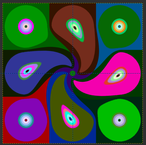

step 6: now you will have something looking like this picture:
maybe you like this pattern as it is and want to keep it, otherwise just use your favie cutting technique to extract your four paisley units - and you're done :)!
