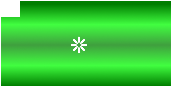

I added 10 pixels of canvas around it, centered and made it image size. That didn't work. I cut a corner out of the top left corner and that didn't work. ~sigh~
I've attached my map.
 Post subject: Re: BRL Easy Map
PostPosted: Tue Sep 09, 2014 4:48 pm  (#6)
You might still be selecting the old map in the dropdown, because your map works. Not sure about the small white image in the middle tho. Seems to add unnecessary artifacts. Might want to darken and cut the contrast a little to get a more shiny and less washed result. Doing that makes the result look like a ribbon. :bigthup
