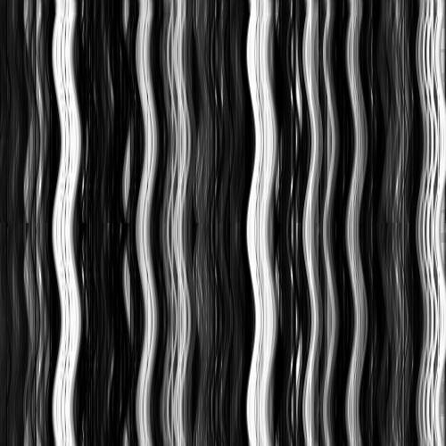

The GIMP Translation:
1. Open a square image (equal width & height - any size) with a white background.
2. Go to Filters - Render - Clouds - Difference Clouds and apply these settings:
3. Select the Blend Tool and use the following settings (there is no right or wrong here - your effect will just appear slightly different than mine and the example in the web tutorial, so don't worry if your example differs than the one shown here):
Using the Blend tool with default black and white colors, mode set to Difference, shape = Bi-linear, follow a similar lay-out of the red arrows, until you get a similar (not perfect) result:
4. Go to Filters - Distorts - Ripples and apply the following settings:
5. Go to Layer - Transform - Rotate 90 degrees clockwise.
6. It was at this point I needed to decide how "fibrous" I wanted my fibers to be. Did I want them to be bristly (coarse) or cottony (smooth). You, too, need to decide which way you want your fibers to look. If you want coarse:
6a: Apply Filters - Artistic - Cubism:
Then apply Unsharp Mask:
6b. If you want smooth fibers, apply a Gaussian blur of 5px, then apply the Unsharp Mask settings you see above.
I went the coarse route, so my fibers look like this, at this point:
7. The next step involves Filters - Distorts - Wind at the following settings twice (once for each direction):
8. Now Filters - Blur - Motion Blur:
9. Now a little darkening is needed. We do that by applying Colors - Levels :
10. Then a final Ripples effect - Filters - Distorts - Ripple:
11. And now crop the outer edge, but maintain a square image. Using the Crop tool, I set my crop area to 455 x 455px, then click the image. You're done! :)

I'm just going to have to play with that tutorial some more. I like the results. I could see using it for watery stuff and also for hair on a cartoon character.
I used your render, mahvin, for this so I wouldn't have to go through all the beginning steps. I set a white layer to Overlay on it to lighten it. I used Noise > Slur and played with the settings (GIMP's Wind filter is not like PS's). After I processed it in slur the results left transparent areas at the top so I duplicated and flipped a layer vertically to fill in the gaps. The blue is from a new layer set to Overlay. I could see this as a flowing river.

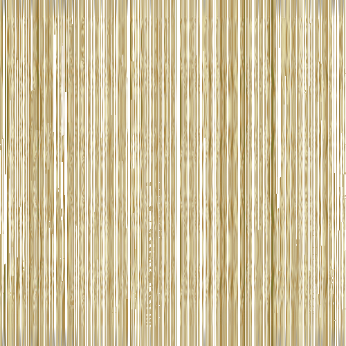

Used this tut as the basis for my result (and of course it's seamless). Additional trick is G'MIC's Isophotes along with a cool plugin called Intelligum (vertical only). Pretty cool Mahvin. :)

I call this one Fake Blond Hair. Left transparent background (Isophotes). It's seamless too. :)
