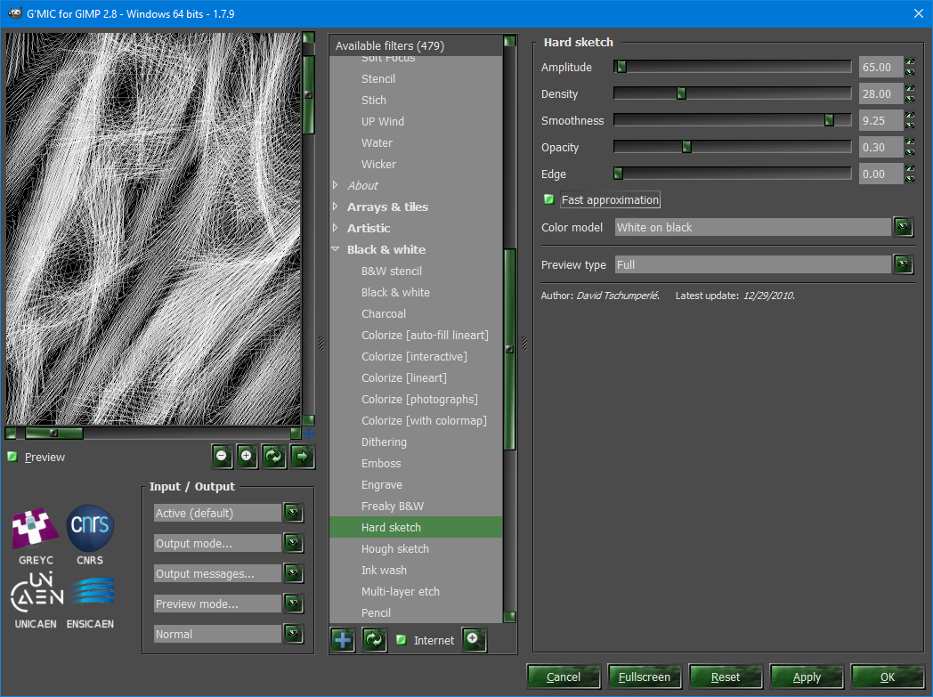

First you dup the target image (again doubled in size already) and run Hard sketch:

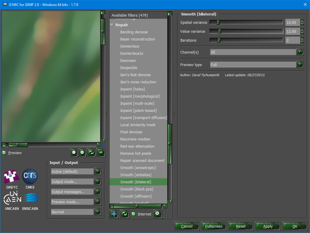

Then you copy your target image to top layer and then dup that layer. Now run Bilateral smoothing on top layer:

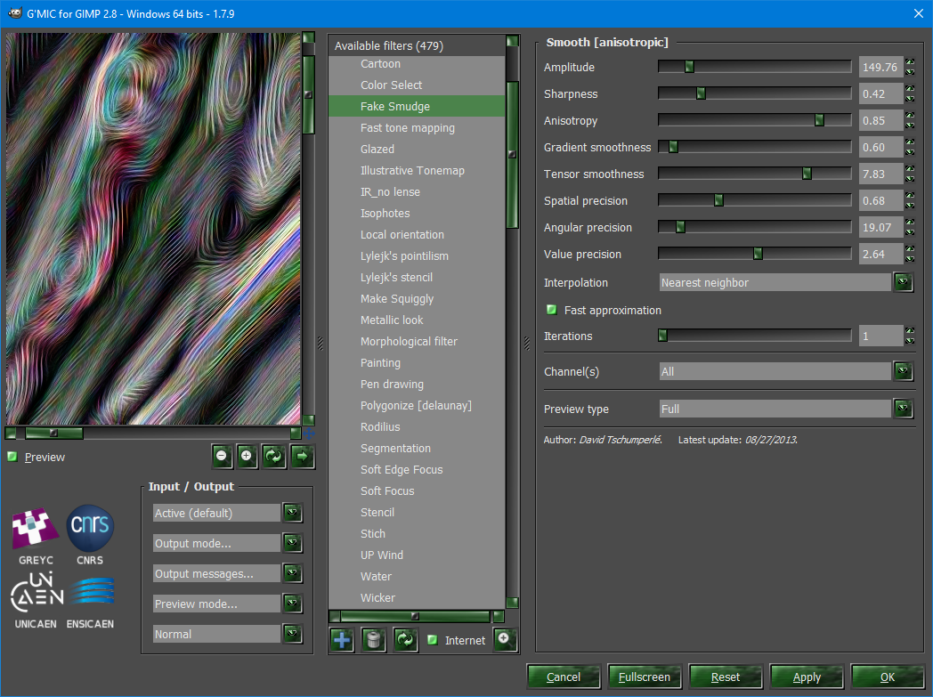

Now, on the multi-convoluted result, run anisotrophic (fake smudge) setting:

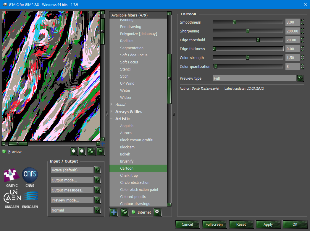

Now, run Cartoon preset on this result:

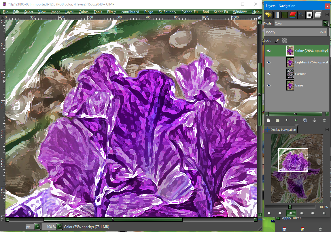

Now copy original on top layer and dup it.
Set Top layer to color and the lower layer to lighten and set opacity to taste:

Whoops; got lazy and just substituted name for the anistrophic preview. Anisotrophic smoothing is located under Repair. Sorry for my laziness. lol
