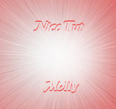

Nice Tut Molly, simple ,yet effective.
I went a step further to show that more can be done with the concept of the SunBurst
The opposing drop shadows are done by splitting the text and making the drop shadows above and below appear to be away from the centre of the sun.

 Post subject: Re: How to make a Sun Burst with GIMP
PostPosted: Mon Dec 26, 2011 6:25 am  (#13)
That is very effective Wbool, love what you did with the text.
Thanks for doing my tutorial.
